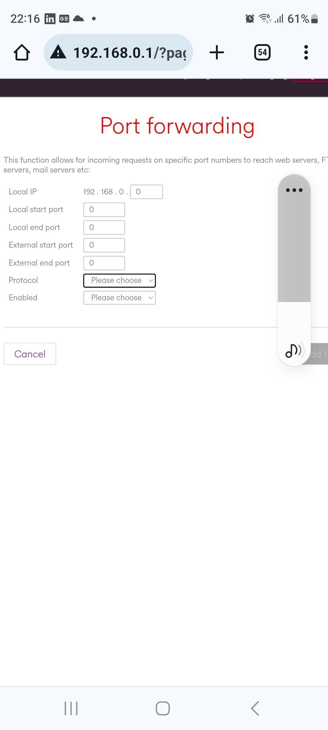

      The lighting device is constantly flashing red indicating a cable/ router issue. The cable is fine.
      I've just found this in the device manual which may be my issue. I have found the advanced settings on the router, but wouldn't know how to translate the manual instruction into what I need to access or change....
      "Also, make sure that there are no non-standard
      firewall/port forwarding rules on your network (the Lightwave Link operates
      on ports 69 & 2011 on UDP for remote connectivity and 9760 & 9761 for local
      connectivity)."

         so basically,  I need to know which piece of info to enter into each field....I think, or do I need to be on a different page? Need someone who knows the terminology.... and don't suggest customer service, if I wasn't already bald I would have been by the end of today speaking (and messaging) to them 🤣

      It's a lightwave rf. It plugs in via ethernet cable. Manufacturer has told me I need to allow port forwarding. See the extract in an earlier post of mine...
      connectivity)."

        Thanks for reaching out to us. Apologies for the issues that you are having with your smart lighting. The Hub5x is compatible for port forwarding and if you're still experiencing, please consult with the manufacturers support Team to make sure they are the correct ports and look into any other security software you may have on your computer to make sure they are allowing connections.
