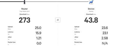

I have a Hub3 with Powerline adaptors sending Wifi to my upstairs and garage. I have recently moved from BT, which I new regret, as I have nothing but trouble and instabilty with Virgin.
With my old (and I mean OLD, it was 3 years old) BT router I have no problems getting maximum broadband speeds upstairs through my Powerline. But with Virgin I find the maximum speeds I can reach are around 70Mb/s (out of 250-270Mbs dowbstairs). If I connect direct to the router via ethernet cable I get full speeds, so it's something to so with how it reacts to Powerline.
I have seen lots of similar posts from people, with no solutions. Interesting, I was at my sister's in London over the weekend, and she has exactly the same issue, absolutely identical.
Has anyone managed to find a solution?

  • The actual throughput speeds on the Powerline system is between 300Mbs and 800Mbs as measured by the app and independently. As I said, I was getting 3-4 times the speed I get with Virgin through my old BT router, so it's not the Powerline that's the problem.

  • speed is 1000 as expected. and yes, we had fibre with BT and we had same speeds downstairs as upstairs. I have found lots of posts online with exact same problem, and my sister has identical setup and also has same problem

      Yes, I've plugged a laptop into the router and I get internet speeds of 250Mps+ (as it should be). I have also tested the Powerline speeds buy talking to a NAS drive at the other end of it, and I get speeds ranging from 280Mbs to 866Mbs. But my internet speed through Powerline is still rooted at around 50Mbs. So it's something about the way Powerline is talking to the Virgin router that is somehow different to the way my old BT router worked.
      The fact that my sister coincidentally has the exact same setup and the exact same throttling issues suggests it's not any kind of fault. A VM engineer has just been around (even though I told the awful customer service people over and over that an engineer was not necessary) and confirmed that as far as he can see, everything is OK.
      Oh, the BT connection was 150/30Mbs though often came in above that. My Powerline speeds were always identical to my Wifi speeds at router.
