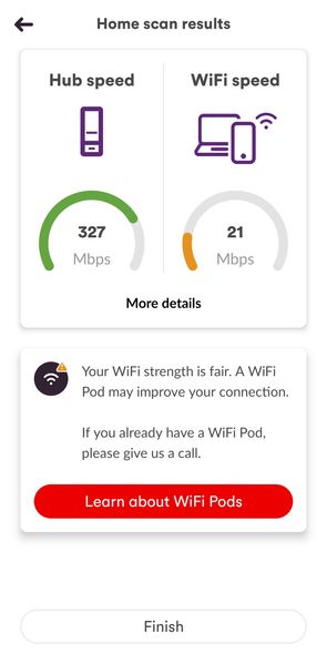

Sudden Slow WiFi Speeds
Hi. Over the last week, the WiFi speed of my broadband has dropped significantly. I am on Volt 350, and I've run the WiFi strength tester in the VM Connect app. It shows that WiFi speed in the living room, which is where the Hub is situated, is very low. I was literally 4ft from the hub. I've tried rebooting the hub, but no difference.

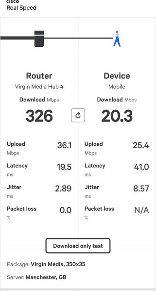

I also ran a test at Samknows.com, which showed similar results.

    The Wi-Fi speed test looks like a mobile that is connected on the 2.4GHz band.
    What make / model of mobile is that ?

      It's a Samsung Galaxy S20, which normally gets around 130mb. All the devices in my house are experiencing the same issue.

      @Client62  Thanks. All my devices had dropped onto the 2.4Ghz band, I have no idea why. I configured the 5Ghz as you suggested and that has sorted the problem, so thank you very much.
