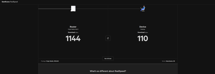

Hey I Recently Upgraded to GIg 1 Internet but I've been having a strange problem to where my speed on ethernet is slower that my speed on Wi-Fi I'm using the cable that came with the box and I've been up to 500-600Mbps but nowhere near the speeds I've been getting I've tried a bunch of stuff I've seen on the forms I've went into safe mode with networking nothing still getting the same speeds tried resetting my router and a couple of other things but no of it seems to be working currently I'm getting 1144Mbps to router and 110Mbps to device and same in safe mode with networking which is really bad its not been this bad before all help would be much appreciated

      Yes the computer is connected directly into the VM hub
      If you mean by the router side then its stable always showing 1Gbps but if your talking about the device side then its at the consistent at 100Mbps

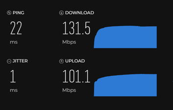

      that's what that website says its showing that it around about the 100-150Mbps mark but if I use something like speedtest.net I'm getting around 450 to max 500Mbps which is better but not close to what I'm paying for

    We see very similar speeds reported from : https://cloudtalk.speedtestcustom.com and  https://www.speedtest.net
    So I am confused by "[from] speedtest.net I'm getting around 450 to max 500Mbps" which is what one might expect and may be at the limit of device as opposed to the VM Hub or service.
