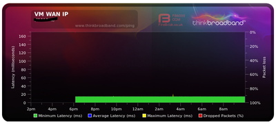

  • mrobinson97's avatar
    mrobinson97
    Just to follow up;
    BQM for VM WAN
    Completely different story to my personal broadband BQM. I guess this indicates an issue between me and the main network.
    Edit: Live link [for the plebs ;)]
    https://www.thinkbroadband.com/broadband/monitoring/quality/share/5a0102d2fd6879454c33436a123d5dd50ebdb611
  • Sephiroth's avatar
    Sephiroth
    Any chance you can post the BQM link as the image awaits mod approval and can't be seen by us plebs?
    mrobinson97
    Of course!
    Sephiroth
    Presumably the uncorrectable errors on the downstream are still present.  As we can rule out a faulty hub, it must be in the circuit (assuming you're in router mode).
    Decoding what you've said the technician did, you have FTTP, with what's called RFoG (Radio Frequency over Glass).  There would then be a white media powered convertor to convert fibre to copper (coax).  Did he check that?
