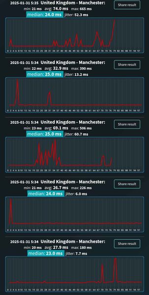

The past 48 hours has been an absolute nightmare. From broadband and TV blackouts to intermittent loss of connection and consistent ping spikes.

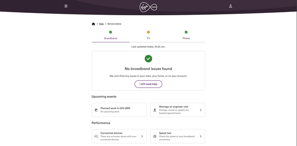

Virgin Media Status keeps displaying:
"Intermittent signal in your area"
"We’re looking into it. Check back here after 24 hours, and if there’s still an issue we’ll help you book an engineer."
However it stays at 24 hours and it's now been 48 hours.
I have no idea what to do since the status page keeps resetting under the assumption that this issue is fixed, ever so often showing, "there's no issues in your area", "there's a problem with our kit", "intermittent signal" and so on.

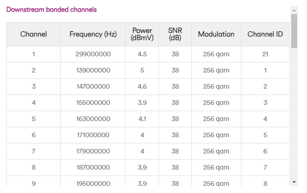

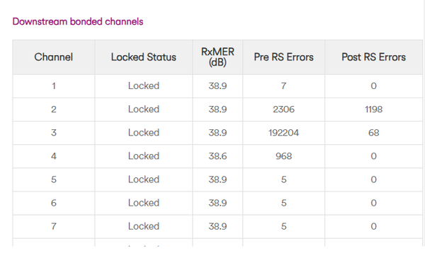

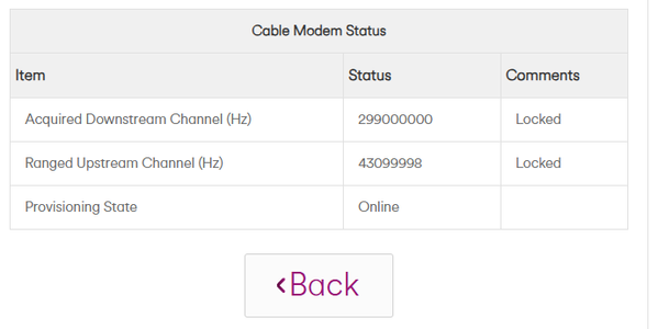

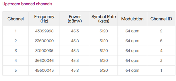

I'm a software tech/comp sci bsc grad. Not that it means anything, more so, I'm fortunately not utterly tech illiterate. I've followed all of VMs tidbits to a tee, brought the network down to a single wired device, tested different channels. Any guidance, suggestions and so on will be taken on board and tested as per request.
