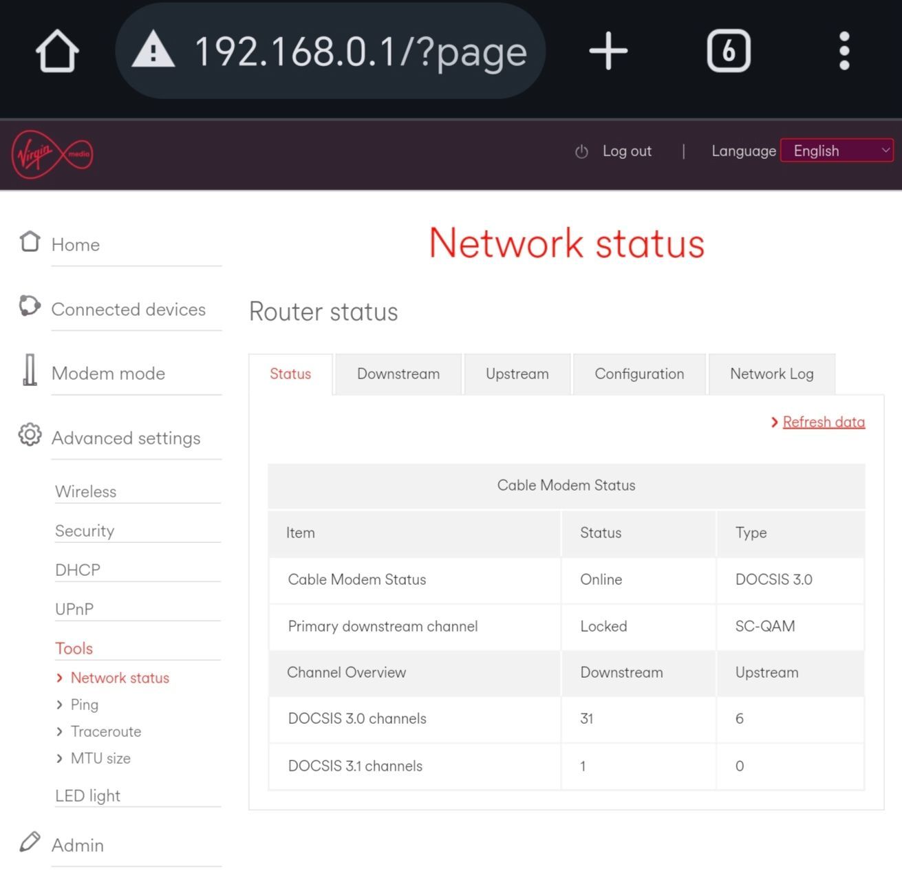

Hi all.
After reading a few posts. It would seem people on the 1gig service have a 3.1 upstream channel.
I currently do not have a 3.1 upstream channel at all.
Is this normal I have attached a photo of the network status page
Also the cable modem status says type DOCSIS 3.0 surely it should read DOCSIS 3.1
1 Reply
    Typically...
    1) CATV connections (that are Coax to the home) do the have 1 DOCSIS 3.1 Upstream channel
    2) RFoG connection (that are Fibre to the home) do not have a DOCSIS 3.1 Upstream channel
