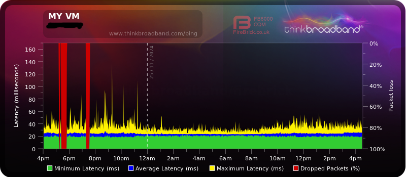

Service drops multiple times a day across Wi-Fi and ethernet connections
Over the last week, I have been having major issues on maintaining a stable connection to the net, I have multiple devices connected via Wi-Fi and they drop many times during the day, even devices which are located and used right next to my Hub 4.
I am also noticing connection drops on devices which are connected via Ethernet, from both being directly connected to the hub 4, and also via a Gigabit switches
We had a major service outage around a month ago, where it was down for 2 days, came back up, then when down again for a day, and was finally stable, but since then I have noticed more drops over Wi-Fi and now across ethernet connections
I have run checks on the connection, via the hub 4 interface, which says everything is working, but I have had 5 disconnections from Wi-Fi this morning and 3 from a PC directly connected to the Hub by ethernet. I have taken these devices to another location and they connect and work fine, so there seems to be an issue with my connection
I have tried to use the support/help via the My Virgin media, but the online element doesn't work, and the phone queue, I am in a long line, any ideas on how I can get this resolved, as I am paying a fortune for a service, which is not consistently working everyday now. Is the Hub on its way out?

  • Problem still persists, tried 3 different PCs directly connected to the router, as well as 2 laptops, all via Cat5e cables, and they all experience drops, but back up in seconds, so its not the devices.
    I have tried numerous different cables, but the same with each new cable, drops, then back up again, so I'm assuming there may ne a problem with the actual ethernet ports on the back of the hub 4 itself.
    With connection showing as stable and OK from the reports, but multiple direct connected devices dropping, wonder if the Hub 4 may be on its way out, as direct ethernet connection, with multiple wires & devices should not be experiencing multiple drops per hour
    Anyone know how I go about requesting a replacement?

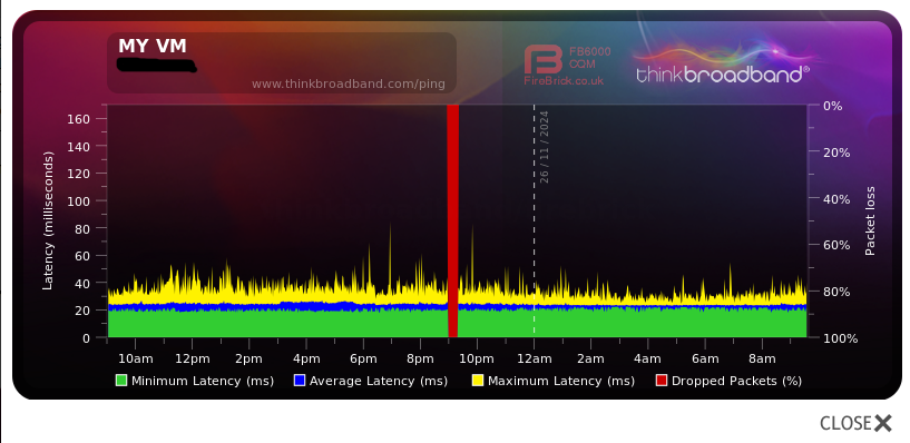

      Thanks for reaching out to us as well as the updates you have been providing on your service status. Could you please provide us with a couple of screenshots from each ethernet port of speed tests using a laptop so we can see how everything is there, feel free to use any speed test service you wish. Sam knows and Speedtest.NET are the most commonly used and do provide more detailed results.
      Pop them on here and we can take a look.

        I will have a look at the weekend, but there isn't an issue with the service speed, that's fine, its the fact it keeps dropping for a couple of seconds, which lead to connection drops, with no reason, across multiple devices, which is why I think its the hub 4, as everything works fine, until it doesn't, with the only difference for each device being the ports on the back
  • Still waiting on an answer, was meant to receive a new hub on Friday, but it appears Yodel have lost it, as they have not delivered it, the status update says its been out for delivery since Friday. I know Yodel are garbage, but 4 days and no updates, with even their webchat saying they don't know where it is. My ethernet connected devices drop multiple times a day, but WiFi stay connected and still work, which is why I believe that the issue is the Hub and the ports on the back. The merry go round of calling VM is not worth it, I just want a stable connection, so I can use the service I pay for
