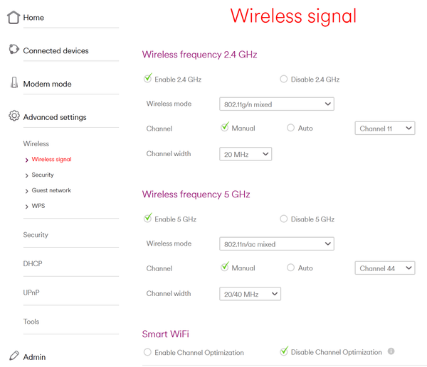

  • Wi-Fi drop outs occur because the Hub 3 is a slow as a snail at performing an Auto Channel change.  We fixed this with the Hub 3 settings shown below.
    The VM Pods are to be avoided, they would compound this problem because VM Pods don't work with the settings show below.

      Thank you! It's early days, but those exact settings seem to have fixed it... and it was enough of a pointer that I've now found some more detail online, so I think I understand the issue and can do a bit more analysis if there are any problems from here.
      In a small but measurable way, you have changed my life :)
      (For anyone who finds this thread in the future, note that you have to select "disable channel optimisation" at the BOTTOM of the page to unlock the settings at the TOP of the page. Fair to assume they didn't bother with any UX testing when they designed it that way.)
