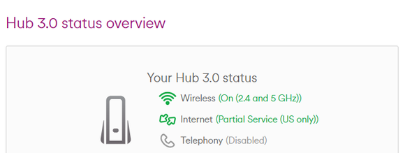

      Update: lots of Post-RS errors have appeared overnight:
