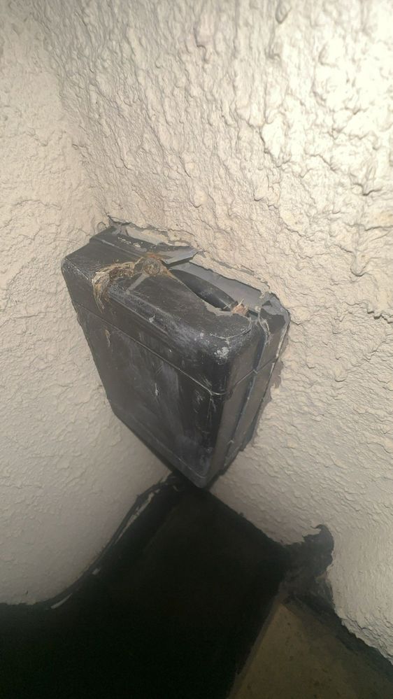

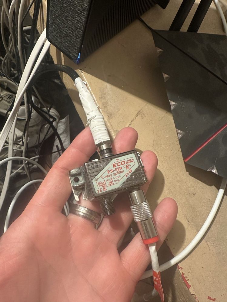

Whilst having a dig around with my equipment and following reconnect and quickstart guides, i've noticed the VM setup in my house isn't "standard". I don't have any wall sockets installed anywhere, just cables coming through the wall. The hubs have always been connected straight to the incoming cable. I connected onto this cable and it always worked so never thought of this being an issue as my property was listed as "quickstart" when i originally signed up. The exterior of my property has some kind of junction box with what looks like splitters for 4 VM connections in different rooms. I can see the cables externally on the house and they all penetrate into the building in different rooms. None of the rooms have VM boxes on the walls, apart from under the stairs where a singular black coax connects straight to the router and has always worked - so it's very confusing. I assume there are multiple disused connections as this property used to be rented. The incoming cable is wrapped in tape and has some sort of splitter connected to it.
As we have always had random drop outs, now more noticeable when trying to game, i believe there could be an issue with the incoming cables to my property and/ or signalling after reading through other users posts.
I have attached some photos as to how my router is connected and the external cracked open VM box. external vm boxincoming VM connection

    If you are now the owner of the property and it is no longer "split" into separate rooms, I would get a VM engineer to sort out the cables.  For starters, that taped connection should be fixed, the un-used connection on the splitter should have a termination cap fitted.  As for the four way splitter, if you are only using one cable, it should also be removed, along with the other redundant cables.  The whole setup at the minute is liable to be creating "noise" on your incoming circuit.  The bare minimum as a stop gap would be fitting 75 Ohm termination caps on the non connected ends as a start ......

    How do I get a VM engineer to remove all these redundant cables and splitter and just fit a singular wall socket? Will I have to pay for this even though it's not my fault? And could this be the cause of intermittent connection?
      IMHO this cable "mess" should be fixed for free, as not only will noise ingress be affecting you, but possibly everyone connected to the same street cabinet.  Cables should not be left unterminated and I would have thought VM would be pleased at getting the chance to fix this?
