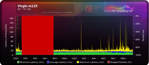

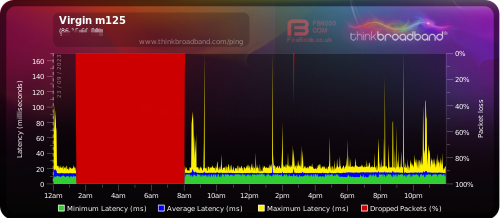

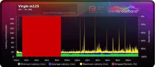

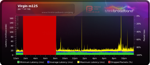

4 days netlog below

I tell you, contact WHICH. If they take up your case, they'll possibly survey more widely in Bristol S and, if they discover that what you report is widespread, they'll take it up with VM and publish whatever they say. WHICH usually gets results.
However, "results" in terms of your contract would be a refund, plus possibly a commitment to place your area into their FTTP plan. But WHICH canl publicly stick it to VM.
Hey septh that sounds good I just haven't had the time to do this but they have forced my hand. I just received this from vm in pm is this legit? Surely I would notice this and it would show in router status no? If it is the case what would cause such a thing please mate.

No they are not doing any work mate as its been like this since I started the bqm when she first rang about her tv always freezing, infact it's usually worse I've uploaded some. When I got time after the end of the week I'm going to contact which and ofcom as our treatment has been diabolical, and the lack of knowledge from the people involved is unreal. They should hire people like you who don't need the best part of a year to find a simple and obvious problem. I've gave them so many chances and they spit in our faces time and time again, just trying to waste time and hope it magically fixes itself. They need to be held accountable for there terrible treatment of customers.

Hmmm it's the all day everyday part that's concerning septh, with the high latency. I find it amazing that no one at vm finds permanently dropped modulations on all 5 channels concerning.... everyday. Not its struggling at certain times of day and drops down a mod but all 5 are dropped all day everyday impacting a variety of things obviously. Everything together netlog bqm and dropped mods speak volumes of there capacity to give a damn about any customers anymore. I'm disgusted at the way there treating us in South bristol and on vm as a whole reading people's bad experiences makes me sick the way they are fobbed off with obvious lies depending on there knowledge and who they speak too, I wish I had the knowledge you do I would be so transparent to them to try to help these poor people, especially in today's climate.

Hi zach, She tells me they do not use apps and it happens on mutiple channels, we have already answered all this and 2 engineers have been already who havent fixed anything, one of which confirmed bad snr after getting off the phone with networks, though that has since disappeared and has been denied (luckily i record all encounters). They just want there tv to stop freezing, as you can see there are big problems with all the data I'm sending, I really don't know what vm want from me you have all the data the engineers haven't fixed it. So some resolution needs to happen moving forward, why does getting any problem fixed with vm take so so long? It's never ending, just give people the service you sell then there is no problem its 2023.
