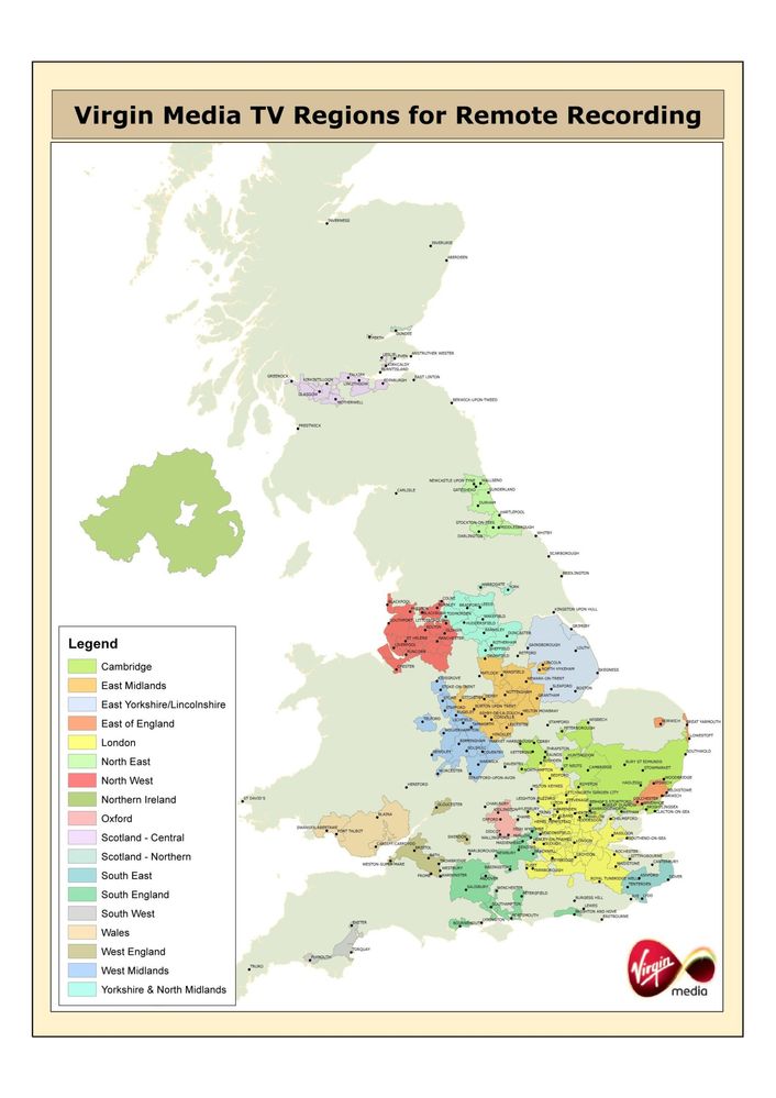

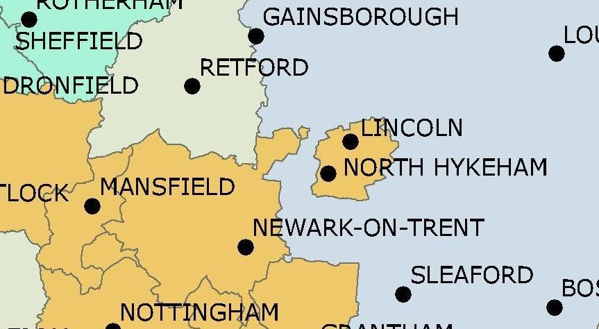

      This is a map of Cable TV service regions:
      Virgin Region Map
      Lincoln is part of the Nottingham cable franchise area fed from the Nottingham cable headend (as a result of the way the country was divided up to make the most money out of selling cable franchises). All customers in a franchise area get the same channels on the same numbers, so you have no option but to get East Midlands programmes on 101 & 103 plus the local channel on 159. For the Yorks & Lincs overlap, additional region feeds are provided on 858 for BBC1 & 870 for ITV1.
