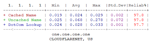

    What would be more informative would be the effect of a stream of nslookups <host> 1.1.1.1
    How many lookups fail via say "DNS Bench" or a similar DNS lookup test.
    • salisburym's avatar
      salisburym
      I get a similar failure rate if I run a DNS lookup every second with a powershell script too.
    On the same test I am seeing a 100% success rate with 1.1.1.1 & both of the VM DNS.
