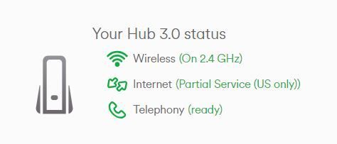

Hi all,
Sure there's a fair few threads on this topic but don't really have much time to look into it much myself at the moment and hoping this is best way for me to get someone to take a look at my connection from the VM side of things.
Been noticing a stutter/packet loss whilst gaming mostly but actually I notice it also when typing in google/youtube etc.
Anyhow, first time I've looked at the router page for some time and it says "Partial Service (US Only)". This is also paired with alot of T3 timeouts in the network log and wondered if it's linked. Feel like I've had some T3 timeouts for a number of years but this appears to be very frequent. Appreciate any advance. Posted below is my router stats. Thanks!

    There are Zero obvious issues with the Upstream Hub data.
    All Channels of the Hub 3 are on 64 QAM and there are ZERO T1 to T4 timeouts.
    Looks like an overloaded game server is the real problem.
    "typing in google/youtube" - this is character echo occurring on your computer.
