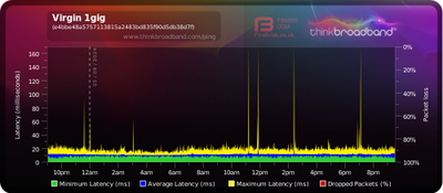

Packet loss every day between 4pm and 12am exactly
Every day for the last week I've been experiencing packet loss that starts at almost exactly 4pm and finishes at exactly midnight.
Have tried pin hole reset of router as advised. Have had a monitor set up but it's saying that my network is fine when it obviously isn't.
Broadband quality monitor link:
https://www.thinkbroadband.com/broadband/monitoring/quality/share/39f93290cfb56146d9819067c5c9d164d25c4c50

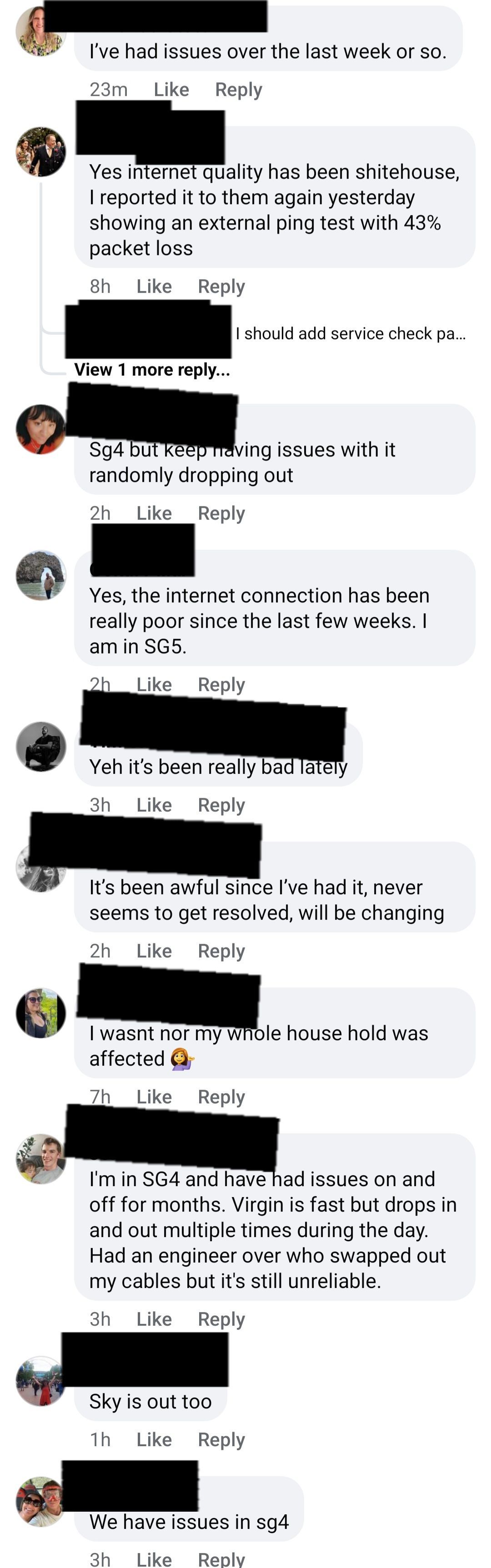

    Thought I'd ask in Hitchin's local group if anyone else had issues.

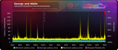

    • User666's avatar
      User666
      Since temp outside stopped hitting mid 20s have not had the 4pm outage. From Monday been like this:

  • My internet has been iffy for a couple of weeks now but has been barely usable this evening until about 15 mins ago - where pretty much fine again. Are they throttling it? It has been great for 18 months. We live in an area with terrible mobile coverage, although SG5, so poor WiFi just isn’t acceptable.
