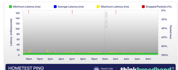

Broadband Drops Every 30 minutes exactly
I have obviously power cycled the router etc, could anyone from VM jump on this to help me out as this has been happening for a week now and it makes doing things online a genuine pain. The disconnects are exactly 30 minutes apart and last for 11 seconds precisely.
2G UP and DOWN connection with a HUB5X.

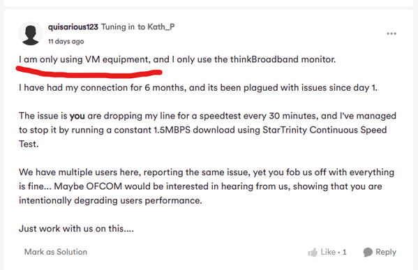

      Can you confirm if you're only using the VM equipment, or do you have any third party equipment connected too?
      Do you have your own software running that automatically checks the network or anything like that?

        So people don't get a good connection for 3 months as shown by BQM which IS to the hub and your "monitoring" IS causing issues for the connection?
  • Same boat, I have Virgin out again today to “have another look”.
    ive pointed out the unusual 30min timing of the disconnects, but they’re adamant there’s no packet drops because their devices show none (of course they won’t, it’s their service that’s causing it) I’ve shown them the quality monitor I’ve been running for weeks proving there’s an issue.
    The only way I’ve been able to mitigate it is to have a large download running at 2.5Mbps+ constantly, this prevents their speed tests from running on your line and thus no dropouts occur.
    I hope you have better luck than I do with this.

      We did reply to you but received no reply. We asked if you're using any third party equipment at all?
