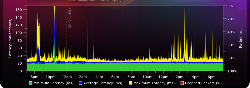

    The red bar might represent a BQM glitch, a service outage or just a piece kit that was disconnected / powered off.
    Look hard at the BQM Graphs - Can you tell where the events occurred ?   Two letter answer on a post card !

      if you look closer every graph has packet loss along the top
