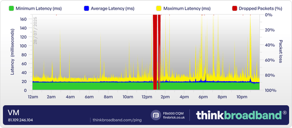

I'm experiencing ongoing issues with my Virgin Media broadband connection, specifically high and erratic latency with frequent ping spikes and occasional packet loss.
An engineer visited yesterday who reset the router and replaced all the cabling, including inside and outside the property.  Unfortunately, the latency issues continued immediately after the visit. Here's a snapshot from my Broadband Quality Monitor. You can see the latency issue is still occurring after the engineer visit at 1 pm.
I called Virgin Media support again, and the operator said that the engineer would come back within 1–2 hours. That never happened, and I’ve had no follow-up since..
Here are my Hub3 stats after the engineer reset my router yesterday.

  • Downstream power levels are too high. You will need an engineer back to possibly fit an attenuator.

      I brought that up yesterday, but the engineer was mainly focused on whether the speed was being met and said she saw no issue with the monitor she shad

    Power levels maybe high but likely are not the cause for ping spikes it might be that the area is high load for the upstream a Docsis 3.1 hub with 3.1 upstream may help. It is also possible you have devices causing the ping spikes which will be harder to find out one way is to let the hub be free from anything that may cause it so change wifi password and unplug wire devices and let BQM ping if it spikes you know its VM network.
