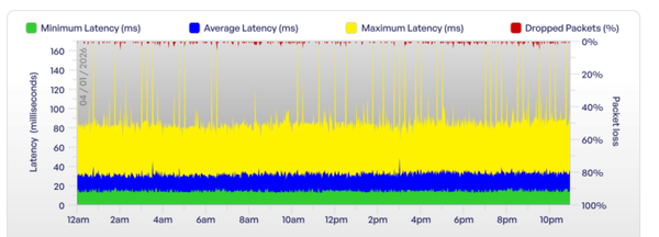

Over the last 12 hours (03/01/2026), the following appears clearly correlated:
  • As downstream power levels rise,
  • Pre-RS error rates increase significantly, and
  • Latency and packet loss increase on the ThinkBroadband BQM
This is visible when comparing:
Grafana modem stats (downstream power + Pre-RS errors)
 BQM (latency, jitter, packet loss)
The rise in errors and latency tracks the downstream power increase very closely. When downstream power stabilises or drops slightly, error rates and latency reduce accordingly.

    A power level change of approx +0.2 dBmV over a 9 hour period is quite negligible.
