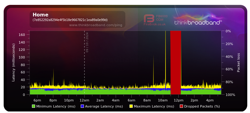

  • @Alessandro Volta
    I wanted to share some insights from the broadband quality monitor I added. It helps show how often I'm facing connectivity issues. I get that outages usually show up as blocks of red, but it seems my router gets stuck in a reboot loop after an outage and can’t reconnect properly. This can leave it unresponsive for quite a while.
    When I'm working from home, having a router that reboots every seven minutes for an hour makes it really hard to get things done. I don’t want to keep saying sorry for leaving and re-joining Zoom meetings due to poor internet.

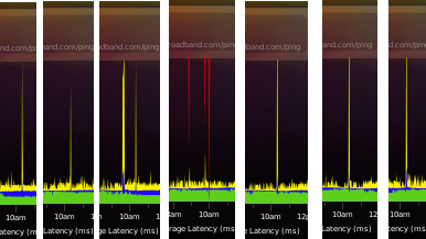

  • I wanted to share my broadband quality monitor data from October 1st to 7th. It shows a consistent issue every morning throughout the week.
