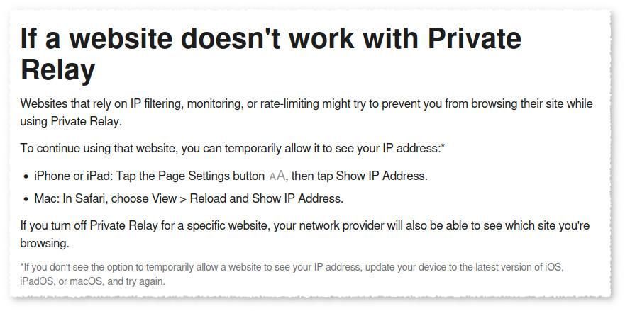

    • 用心棒's avatar
      用心棒
      Midinotes wrote:
      Hi Philip
      I get exactly the same result as you on my iMac (which works fine with 3churches.org). However not sure how I do this command line test on my iOS devices to test.  Will have to research that!
      Maybe easier to follow Apple's advice and disable Private Relay for just that site to see if it is the issue.
      [Source: Manage iCloud Private Relay for specific websites, networks, or system settings - Apple Support]
