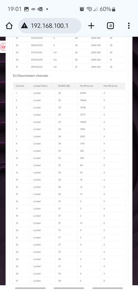

  • Hi same issues as before SNR under spec even without headroom, upstream modulations dropping, I had yesterday about 30 upstrram profile changes, all of which is effecting normal performance. Billions of codeword errors. Would appreciate a resolution to this.

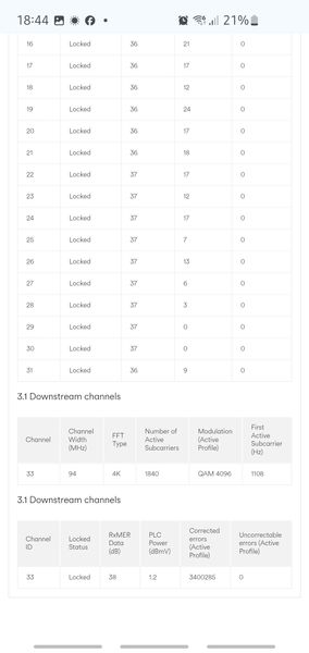

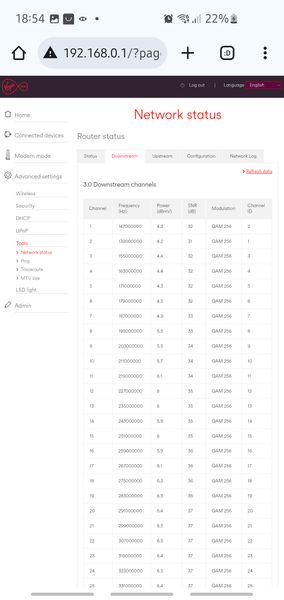

        Hi ive had this superhub5 for quite some time using the 2.5g port for my router, this would not cause the SNR to drop, all wiring inside my home is new and correctly installed checked many times previously by engineers and senior engineer Tom. I think an engineer need to check externally to my home for connections as mer and snr are far to low, noise floor close to signal and has no headroom. I think this needs more than guess work, I made a complaint but recieved overseas responce unbelievably about my wifi and as usual nothing to do with what my complaint is about. Cannot believe vm is out sourcing for COMPLAINT resolution that speaks volumes about customer care, i don't want to use an ombudsman and have you fined I'm hoping to sort this quite quickly, but every time I come back to get a resolution it gets more an more unbelievably dragged out no help passed around. So sad what's happening to our once great virgin the forum is packed. :(

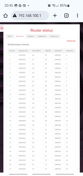

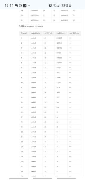

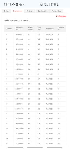

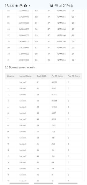

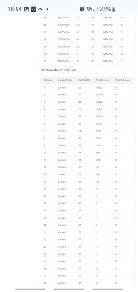

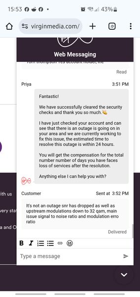

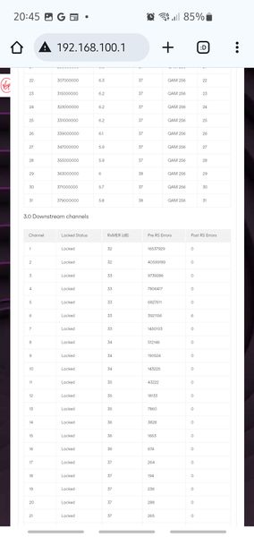

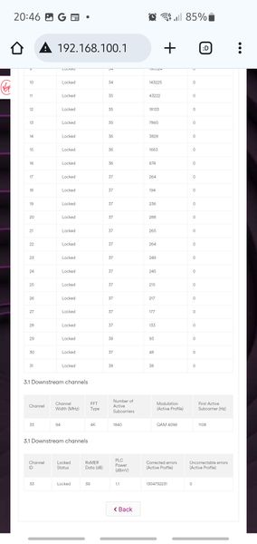

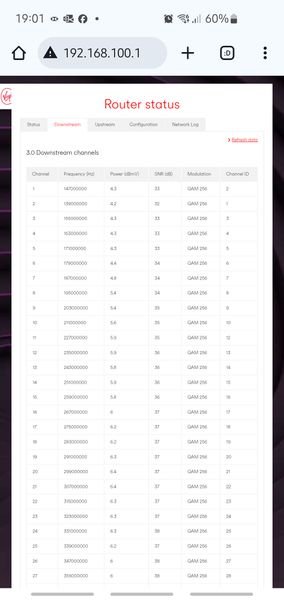

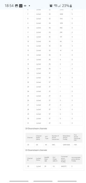

  • Back again can anyone help please just made a complaint sick of this, I left it for months as can't be bothered due to family illness  but now really effecting streaming etc snr dropped really low pre RS straight after a fresh 60 sec reset populated tens of thousands. My ip in router mode was the same as my super hub after long reset?

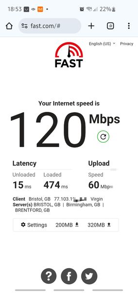

     Error ratio mer is dropped loads as have snr, without my router speed test is 100/60 on a gig connection. 1st 4 pics just after a full 60 sec reset with ethernets out, others on my router day or 2 ago.

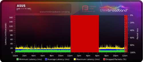

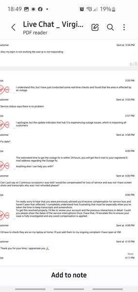

      Hello why is my bqm not working with my ip assignment, also i used to have a different ip address in hub mode ( whatismyip.com) and another assigned on my router while hub in modem mode. Now there the same? Is this a problem like I said my bqm isn't working now, snr issues still now my upstream is dropped all modulations been fine till now, any help please.

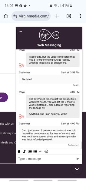

        So yesterday was told by vm that my problem was outages and i was assured it would be fixed in 24hrs and I would be compensated. Well snr still the same haven't received anything from vm an update nothing just done reset no update just the same old same old.

        Slightly different topic to keep focus no evidence of overselling from your BQM you posted.
        The profile on the 3.1 upstream channel changing is for the same reasons as the 3.0 channels lowering modulation. It's to try and cope with noise.
        The reduction in the 3.1 channel was a widespread thing, not just you, to improve reliability. The channel was notched as there was a narrow band of interference. High power radio transmissions get onto the cable network as unterminated coax points in homes act like antennae.

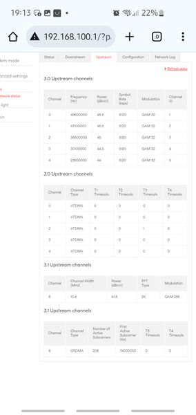

      You have an upstream noise issue and possibly power level issue on downstream bonded channels. Without seeing your stats, hard to confirm for latter. Sometimes this can be a faulty hub, it's usually connectors not tightly done up, a damaged cable or connector inside or outside the property. Thus is why you have intermittent loss of modem registration and obtain the correct channels.
      I'd ask VM for a tech visit if not an area issue as they can redo connections and fit an equaliser if power levels too strong. They can also escalate to networks if a cabinet issue or CTMS issue or request a cable pull if outside cable damaged (eg by rats or mice and water can get ingress).

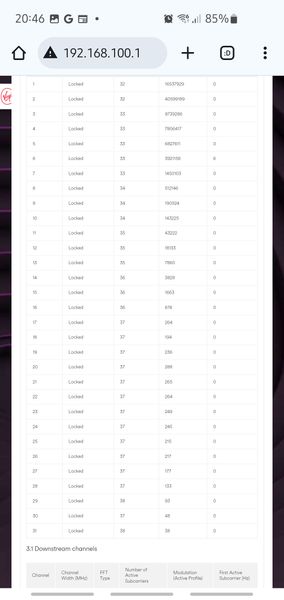

        Was on there system as an area fault after its so called fix still modulations dropped to 16QAM, 3 billion errors on the downstream 3.1 active profile after a day or 2, using profile 12/13 for upstream when 11/13 is better. Changing multiple times a day what's up with that?.

      Back up and running now but US modulations all at 16qam and have a violation for up stream power? Dynamic Range Window violation, it still doesn't let people upload stats?
