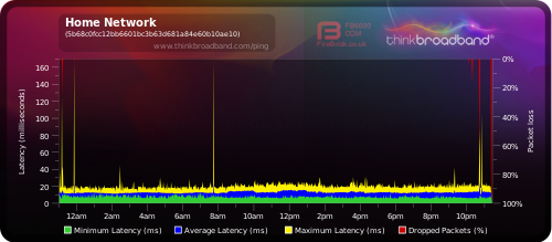

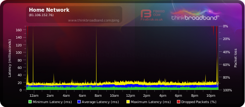

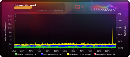

New customer, constant disconnects
I’ve been having issues with my Hub5. It randomly disconnects at night for 5 minutes intermittently for the past 3 days. My internet goes down for about 5 minutes, then returns, then goes down again. Very annoying for streaming or online play.
I’ve had errors ranging from “No Maintenance Broadcasts for Ranging opportunities received” to “DBC-ACK not received” to “SYNC Timing Synchronization failure” to “No Ranging Response received”. I have the network logs, and setting a BQM will just illustrate my downtimes as mentioned above.
I also get 800mbps on an Ethernet connected device, when I should be getting <1gb as it’s a paid service.
Is this a Hub issue? Im seriously considering returning everything and the service and switching providers or something. This headache is not something I signed up for.
Im in the GU2 area if that makes any difference.
Am I entitled for compensation here?
I’m not even going to try calling…I can’t stand that bot you have triaging customer service

  • Can someone tell me how to get the attention of the mod team? I tried posting the logs but get errors on the forum. What specifically do you need here?
    you can see it below. It just happened again.
  • To be clear it flashes red for a second during these outages.
  • I also have these types of errors and sometimes the hubs light will flash red. Is the hub faulty and overheating?
    “RNG-RSP CCAP Commanded Power in Excess of 6 dB Below the Value Corresponding to the Top of the DRW”
