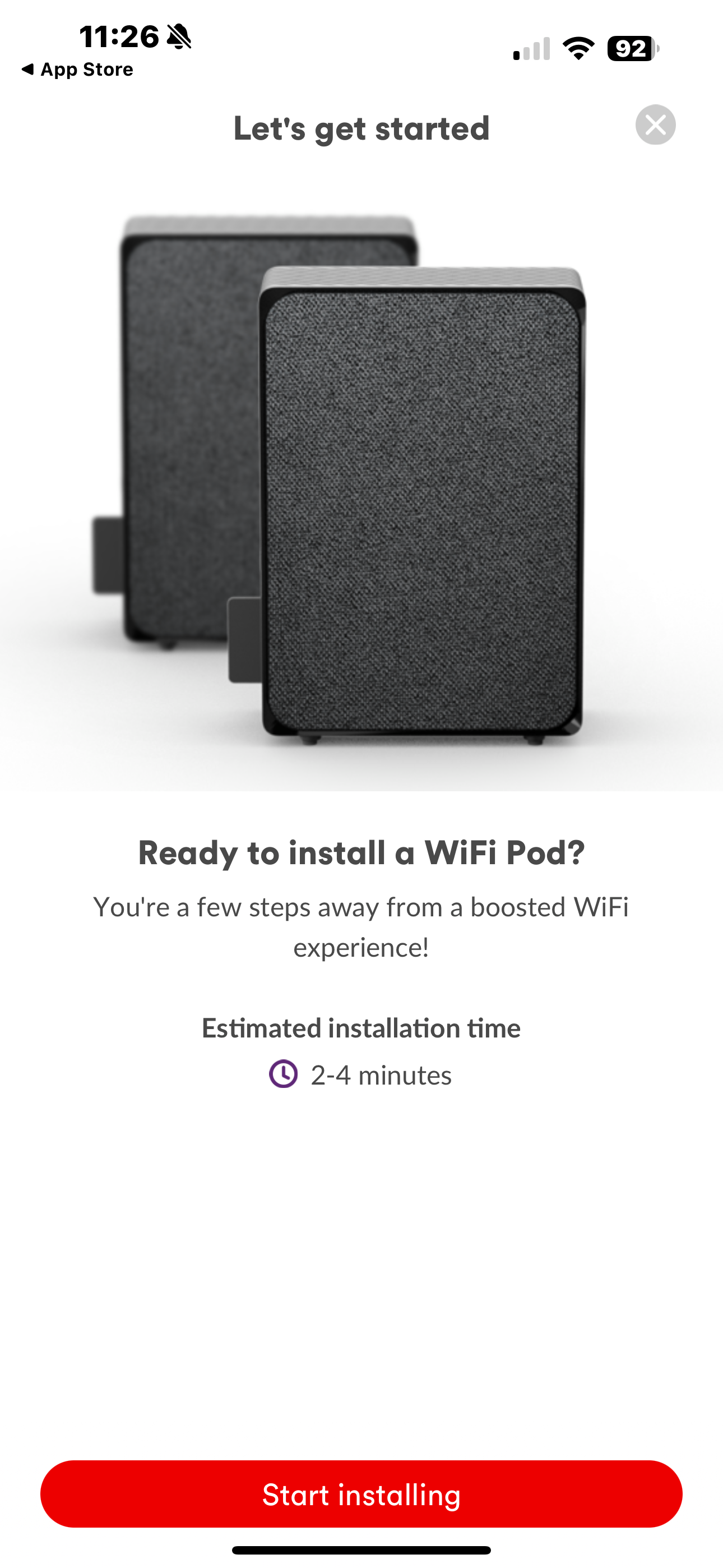

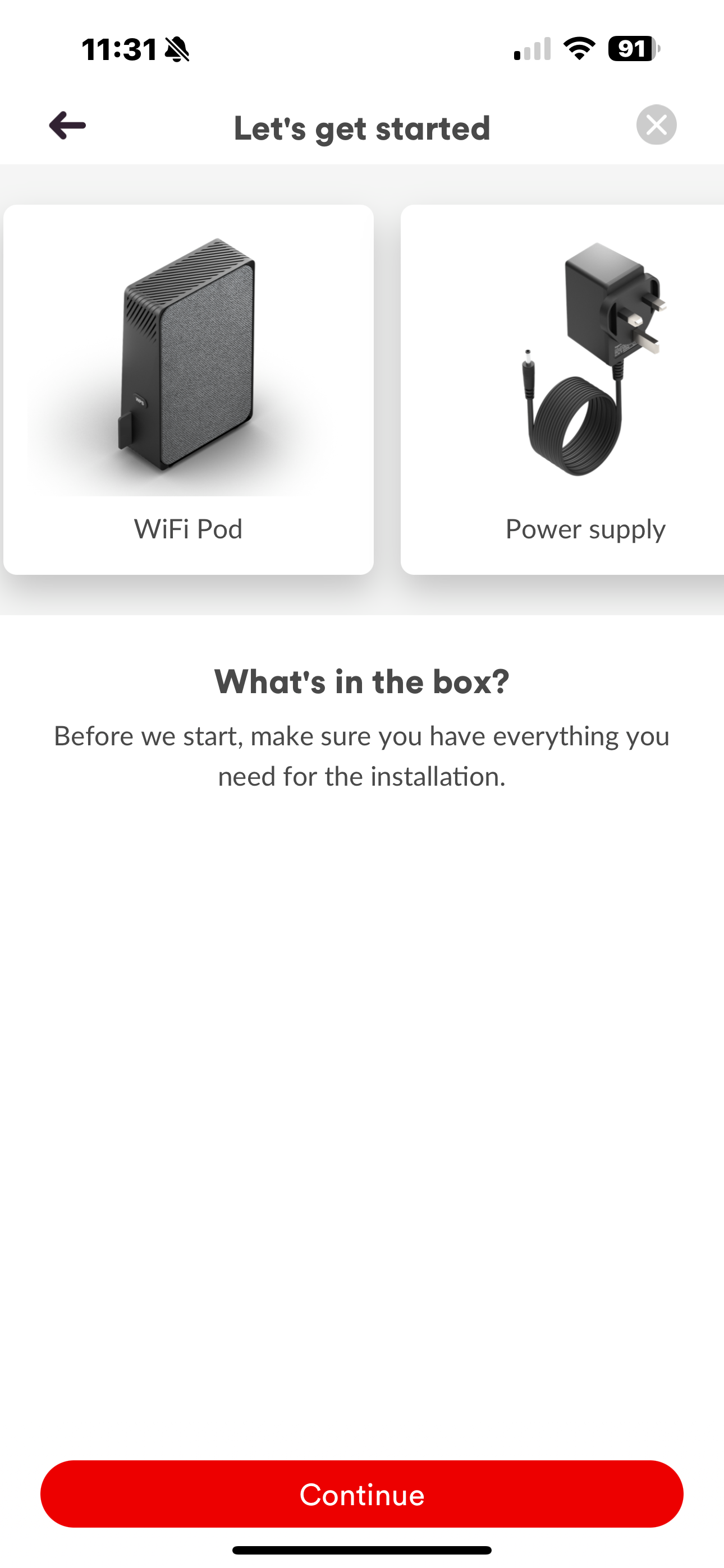

Does anyone actually know how to get these pods to work? I've just received 2 of them and when I plug them in the light keep cycling from blue pulsating to green pulsating then to white and back to blue! They aren't showing up on my connect app either! I also had the white ones that kept working for like a week then would disconnect from my hub 5 and wouldn't reconnect
- Dave_J1On our wavelength
The pods have not been associated with your hub, send a private message to one of the forum team members and they can fix it for you, better than using the usual customer service contacts.
