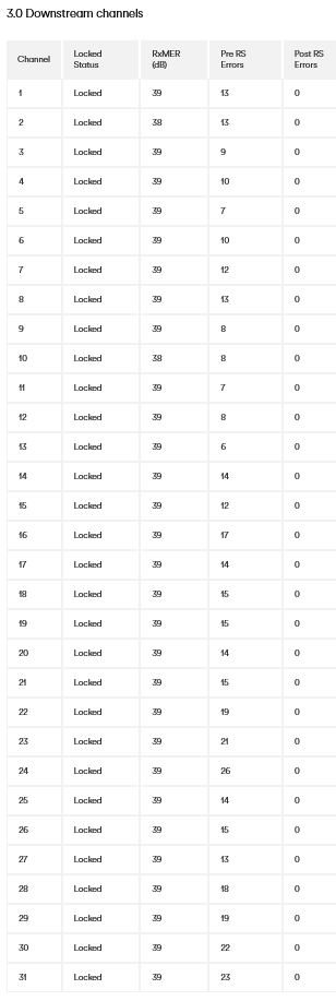

network status
3.0 Downstream channels
13620000004.739QAM 2561
23700000004.238QAM 2562
33780000003.939QAM 2563
43860000003.539QAM 2564
53940000003.439QAM 2565
64020000003.339QAM 2566
74100000003.239QAM 2567
84180000003.139QAM 2568
94260000002.939QAM 2569
104340000002.838QAM 25610
114420000002.739QAM 25611
124500000002.839QAM 25612
134580000002.539QAM 25613
144660000002.439QAM 25614
154740000002.239QAM 25615
164820000002.139QAM 25616
17490000000239QAM 25617
184980000001.839QAM 25618
195060000001.639QAM 25619
205140000001.639QAM 25620
215220000001.639QAM 25621
225300000001.539QAM 25622
235380000001.539QAM 25623
245460000001.439QAM 25624
255540000001.439QAM 25625
265620000001.439QAM 25626
275700000001.439QAM 25627
285780000001.439QAM 25628
295860000001.339QAM 25629
305940000001.139QAM 25630
316020000001.139QAM 25631

  • Channel Locked Status RxMER (dB) Pre RS Errors Post RS Errors
    1Locked39130
    2Locked38130
    3Locked3990
    4Locked39100
    5Locked3970
    6Locked39100
    7Locked39120
    8Locked39130
    9Locked3980
    10Locked3880
    11Locked3970
    12Locked3980
    13Locked3960
    14Locked39140
    15Locked39120
    16Locked39170
    17Locked39140
    18Locked39150
    19Locked39150
    20Locked39140
    21Locked39150
    22Locked39190
    23Locked39210
    24Locked39260
    25Locked39140
    26Locked39150
    27Locked39130
    28Locked39180
    29Locked39190
    30Locked39220

      pre post errors and 0 post errors, is this okay? and the other stats?
  • i do gaming online, if there is anything that looks like it could be improved on the stats please tell me

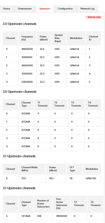

    Upstream also critical for gaming. Assume you are ethernet connected.
    • willows2's avatar
      willows2
      I do have lagg when i play shooter games, but it might be the gamer servers.
      I have provided my upstream for you, and i do use ethernet.
      The stats I have provided has a 10dBV forward path attenuator attached to the router already.
    Game lag very often due to use of Wi-Fi & worse Wi-Fi Pods / Repeaters and Game server overload.
    Upstream look fine too.   This looks very much like our RFoG connection.
    Leave the 10dB attenuator on the line, your Downstream signal are in the -7 to +7 dBmV preferred range, removing the 10 dB attenuator would exceed this and not be an improvement. Without the -10dB the Upstream signal level would be affected, Hub transmission level would drop.

    Posting partial stats isn’t really helpful as it masks the bigger picture.  From what can be seen, the post-R/S errors, if not climbing, will be due to the line chaos that occurs with a modem reset and the modem hasn’t yet synched with the VM end.
    I’ve noticed that you only show 31 DOCSIS 3.0 downstream channels (I would have expected 32), and no DOCSIS 3.1 downstream channel.  Can you confirm this please?  It ought to have been picked up by the Forum Team.
