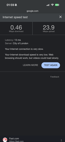

      Also attached a speed test I did last night when I experienced a blip
  • So update, managed to get an engineer booked to take a look. The issue seemed to be with the cabinet, the tap connector I was hooked onto was not giving a response so they will book a Network engineer to get this fixed as there were a few taps not giving responses. The engineer has connected me to one that's giving a stronger response and wifi seems to be a lot more stable since!
    Thanks to Kash :) , will keep an eye on this and then mark as solved if no further issues
      Looking at your earlier stats, your power level are fine, so not sure why "you were not getting a response"?   If you need to check the Downstream range is -6 to +10 and the Upstream range 34 to 51.  PostRS errors should be zero or close to.  Upstream should all be 64QAM.
      The VM "approved" speed test is http://www.samknows.com/realspeed using a wired connection if possible.  The client for this test is built into the VM Hubs, but only works in Router mode btw.
      It would be interesting to see what the stats are now, after they moved your tap in the cabinet...
