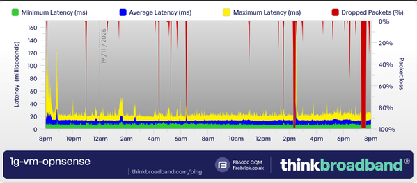

Network dropping out
Over the last few days our internet has been disconnecting a few times per day, and today 7 times already.  Each time its for about 30sec-1min, so I did a factory reset of the modem and within mins of it being back online it has already dropped 3 more time.
I've checked my modem stats, and there are over 80million corrected 3.1 errors and 26k uncorrectable errors since I did the factory reset just 40mins ago.
I used to check this every few weeks, and it has always been a massive number, reaching something like 4billion before it would seemingly reset to 0. It took about 4 days to reach that number, but in the last few weeks its getting to that number in around 36 hours.
Never really had any speed or latency issues until the last few weeks.

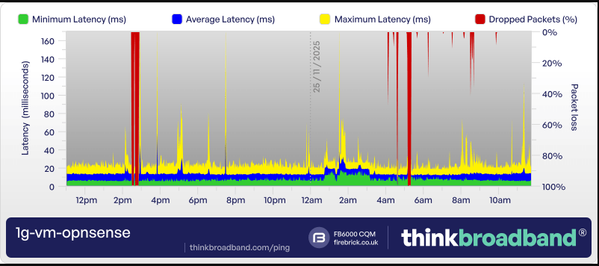

    • padeath's avatar
      padeath
      Hi,
      The connection has been really bad all week, so yesterday (Saturday 22/11/25) I switched the hub to router mode. I usually have it in modem mode and use my own router. Since then there hasn't been any drop outs.  I'm not sure why switched to router mode would fix the issues, as I've been getting a lot of uncorrectable errors in the last few days.
      This morning (23/11/25) I have switched it back to modem mode so that I can use my own router and I'll see how it goes from there.
      While the connect is up, speeds are fine, its just been dropping the connection 5-10 times per day over the last week, and as I say the uncorrectable errors reached over 500,000,000 on the 3.1 downstream and over 3,000,000,000 corrected errors, which is a huge amount in just 2 days!
  • padeath's avatar
    padeath
    An engineer came yesterday and he did some changes, added an attenuator and something outside too to get the 3.1 downstream into spec as his equipment was showing it to be out of spec. Since then the internet has dropped out 5 times already.  I'm seeing 1.8billion corrected errors and 1.8million uncorrected errors since the hub was rebooted just 15hours.
    • padeath's avatar
      padeath
      I've been on chat with VM this morning, and went over everything again with them.  They asked if I'm using the 2.5gbps port, which I am and my hub is in modem mode.  They said there is a new issue with the hub5 and the 2.5gbps port that will be fixed soon and that I should use the 1gbps port in the mean time.  How can me using the 2.5gbps port cause error at the DOCSIS level? I now have 4.6million uncorrected errors and the internet has dropped out a couple more times.
      Also someone else on my street (of just 20 houses) is having the same issues, their internet has been going off for the last week and also this morning like mine did.

    25-11-2025 08:37:21	notice	CM-STATUS message sent. Event Type Code: 24; Chan ID: 49; DSID: N/A; MAC Addr: N/A; OFDM/OFDMA Profile ID: 0 1 2 3.;CM-MAC=;CMTS-MAC=;CM-QOS=1.1;CM-VER=3.1;
    25-11-2025 08:37:17	notice	CM-STATUS message sent. Event Type Code: 22; Chan ID: 49; DSID: N/A; MAC Addr: N/A; OFDM/OFDMA Profile ID: N/A.;CM-MAC=;CMTS-MAC=;CM-QOS=1.1;CM-VER=3.1;
    25-11-2025 08:36:28	notice	CM-STATUS message sent. Event Type Code: 4; Chan ID: 25 28 32 33 34 35 37 38 39 40 41 42 43 44 45 49; DSID: N/A; MAC Addr: N/A; OFDM/OFDMA Profile ID: N/A.;CM-MAC=;CMTS-MAC=;CM-QOS=1.1;CM-VER=3.1;
    25-11-2025 08:36:09	notice	CM-STATUS message sent. Event Type Code: 23; Chan ID: 49; DSID: N/A; MAC Addr: N/A; OFDM/OFDMA Profile ID: N/A.;CM-MAC=;CMTS-MAC=;CM-QOS=1.1;CM-VER=3.1;
    25-11-2025 08:35:31	notice	CM-STATUS message sent. Event Type Code: 1; Chan ID: 49; DSID: N/A; MAC Addr: N/A; OFDM/OFDMA Profile ID: N/A.;CM-MAC=;CMTS-MAC=;CM-QOS=1.1;CM-VER=3.1;
    25-11-2025 08:35:17	notice	CM-STATUS message sent. Event Type Code: 20; Chan ID: 49; DSID: N/A; MAC Addr: N/A; OFDM/OFDMA Profile ID: N/A.;CM-MAC=;CMTS-MAC=;CM-QOS=1.1;CM-VER=3.1;
    25-11-2025 08:35:17	notice	CM-STATUS message sent. Event Type Code: 21; Chan ID: 49; DSID: N/A; MAC Addr: N/A; OFDM/OFDMA Profile ID: N/A.;CM-MAC=;CMTS-MAC=;CM-QOS=1.1;CM-VER=3.1;
    25-11-2025 08:35:17	notice	CM-STATUS message sent. Event Type Code: 16; Chan ID: 49; DSID: N/A; MAC Addr: N/A; OFDM/OFDMA Profile ID: 0 1 2 3.;CM-MAC=;CMTS-MAC=;CM-QOS=1.1;CM-VER=3.1;
