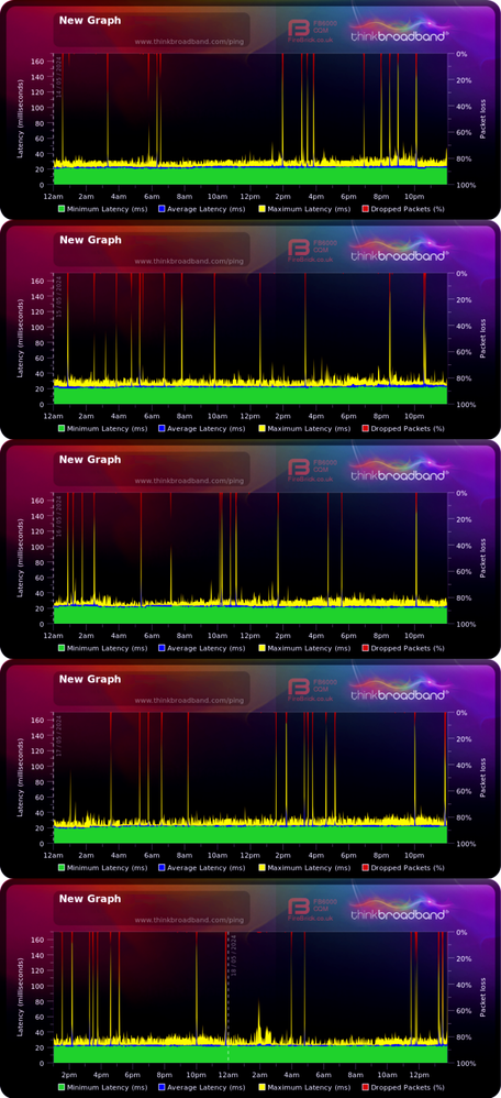

I've been experiencing intermittent loss of broadband signal for a few months now. I've put up with it for long enough. The following BQM graphs are from the last 5 days. But I have a couple of months of graphs showing exactly the same thing. My Network Log shows quite clearly that this is a SYNC Timing Synchronization failure - Loss of Sync
Rebooting the system doesn't make any difference. I've checked to make sure all my connections are tightened. I'd like an engineer visit to address the ongoing issues asap. Thanks.

  • jbrennand's avatar
    jbrennand
    Not great - but can you start from a clean sheet and do this..
    ___________________________
    Switch the Hub off and unplug it from the mains supply for five minutes. Whilst it's off, do a quick check that all of your coax and ethernet cable connections are in nice and "finger" tight - at the Hub and wall box and also at any connectors etc. Ensure there are no “unterminated cable loose ends. Disconnect all the connections and reconnect to be sure. Also check that the internal wiring is ok with no kinking or chaffing. When its light, check that all looks good with the outside cabling and wall box (no “staples, etc.,) piercing the cables. Then switch the Hub back on and leave ~5 minutes When all done, check back in the settings and ensure that the RS error counts and T3 errors have all reset to 0. Then check every hour or so to see if they start reappearing - they shouldn't. If they do (particularly the postRS and T3 ones) you have a problem (noise) that only a Tech visit will sort.
    Also check the Upstream QAM’s are all at 64
    • c0balt's avatar
      c0balt
      The only thing I wasn't able to do was check outside. As I'm housebound.
      These were taken 5 mins after hub reset ...

      18/05/2024 16:26:58
      Warning!
      RCS Partial Service;CM-MAC=**:**:**:**:**:**;CMTS-MAC=**:**:**:**:**:**;CM-QOS=1.1;CM-VER=3.0;
      18/05/2024 16:25:33
      critical
      SYNC Timing Synchronization failure - Loss of Sync;CM-MAC=**:**:**:**:**:**;CMTS-MAC=**:**:**:**:**:**;CM-QOS=1.1;CM-VER=3.0;
      18/05/2024 14:34:43
      Warning!
      18/05/2024 14:26:24
      critical
      18/05/2024 13:55:46
      Warning!
      18/05/2024 13:55:46
      critical
      18/05/2024 13:54:16
      notice
      LAN login Success;CM-MAC=**:**:**:**:**:**;CMTS-MAC=**:**:**:**:**:**;CM-QOS=1.1;CM-VER=3.0;
      18/05/2024 13:47:18
      Warning!
      18/05/2024 13:45:47
      critical
      18/05/2024 13:27:37
      Warning!
      18/05/2024 13:27:37
      critical
      18/05/2024 13:26:46
      Warning!
        jbrennand
        OK - thats not good - too many PostRS Errors, SNR's are all low and the BQM looks awful.
        What devices do you have connected to the Hub on ethernet cables ?
        A VM Person will be along here soon and take a look for you
