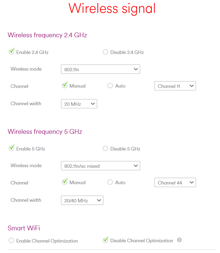

VM Hub 3's WiFi Channel Optimisation can be a source of dropped connections.

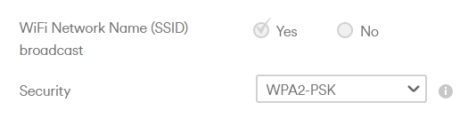

Our Hub 3 provides very stable WiFi with the following options set in the Hub's menus :
Wireless Security- dbcallaghanJoining in
