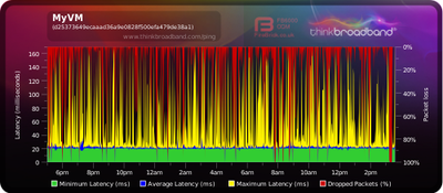

      • Itsjustsmithy's avatar
        Itsjustsmithy
        Thanks for your reply. I have done as you said. Can't see anything wrong with internal or external cabling or box. Could this be caused by someone else getting VM installed with a box close to mine? I can't remember if they got it installed before or after my issues started.
        Below is the RS errors after reset & BQM for today, the QAM is 32 straight away from reboot. I have a tech visit in two days time if they don't cancel again.

        21-11-2024 14:23:25critical16 consecutive T3 timeouts while trying to range on upstream channel 2;CM-MAC=**:**:**:**:**:**;CMTS-MAC=**:**:**:**:**:**;CM-QOS=1.1;CM-VER=3.1;
        21-11-2024 14:23:25criticalUnicast Maintenance Ranging attempted - No response - Retries exhausted;CM-MAC=**:**:**:**:**:**;CMTS-MAC=**:**:**:**:**:**;CM-QOS=1.1;CM-VER=3.1;

      This is one for the tech!  VM will reply here soon but try calling in as well - they should spot the same.
      BTW - are you in modem mode ? If so you will need to go back to normal router mode.
       Your up channel power levels are all way to low and need adjusting - and qam's dropping to 32 - probably move your "tee" position in the street cabinet.

  • No known issues on either. The app did say there was some planned work a few weeks ago after my issue started, I thought that the work may solve the issue but it didn't, this is when I decided to contact VM.
