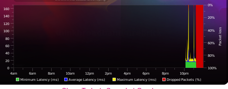

    Set up a Broadband Quality Monitor (BQM), get your WAN IP address from http://whatsmyip.com then use http://www.thinkbroadband.com/ping/monitors.html

  • Thank you for trying to help, I have signed up and put my IP in for the BQM, I just checked and its started to monitor..
    Sorry, I'm not highly savvy when it comes to networking, I've tried to follow what you asked for below:
    The internet is quick when it works, it just drops connection like 30 times per day. I did  the speed test anyway just incase. Cheers.

  • I don't know why but its showing red, I considered perhaps it disconnected and my IP changed but no its still exactly the same IP
