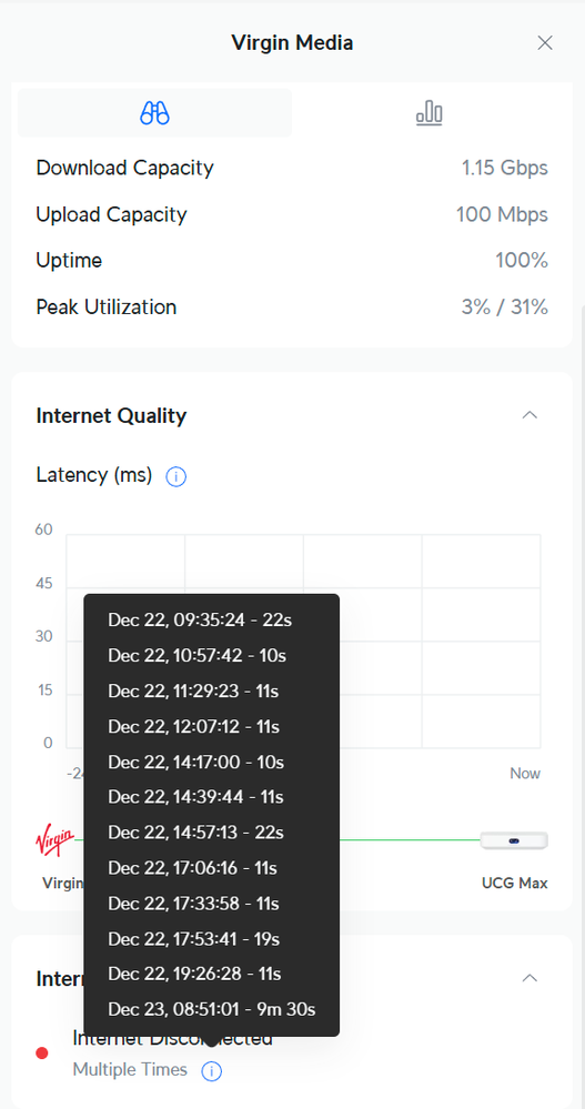

      I did a full reset and the counts have all gone back to 0 now. I will keep checking and see how it goes over the day today. Initially after about 10 minutes I can see some Pre RS errors but nothing Post RS. All the upstream channels are QAM 64.
      Here is the link to the the offsite quality monitor. It took me a while to figure out how to configure my firewall to allow pings from that server but I got it after a couple of hours of tinkering.
      https://www.thinkbroadband.com/broadband/monitoring/quality/share/0f641a96015d3ced7a5fe4b897a5e9569fc9cf59
      These are the disconnects over the last 24 hours.
