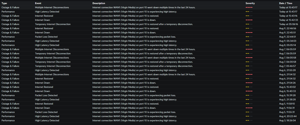

Multiple Disconnections on a Daily Basis
Been getting a lot of random disconnections lately, my Hub 5 is in modem mode and when I called support they said I'd need to reset it fully back to router mode, before they can diagnose the problem.
ChatGPT suggests this based on my logs: Thanks for sharing the full log, Paul — this paints a very clear picture. Based on the sequence and types of errors, your Virgin broadband connection is experiencing signal instability at the physical layer, likely due to upstream noise, power level mismatches, or line degradation.
Do I really need to do a full reset before support will engage?

      What other stats are needed, I included upstream/downstream stats in reply?

      BQM looks to be setup wrong or your router is not allows ping for BQM
      • pdagnall's avatar
        pdagnall
        Yeah unfortunately on the latest Unifi OS, you can no longer expose WAN interface to external ICMP.
