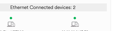

The network light is on on the usb-hub.  Logging into the Hub 3 shows (I think) that it's connected too.   (The other device is NAS drive)
