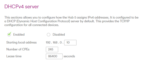

Just upgraded from a Hub 3 (DHCP range 192.168.10.10 thru 192.168.10.250) to a Hub 5
My problem is I can't see where to change the penultimate digit of the DHCP range from 192.168.0.x to 192.168.10.x - reason being is I connect to different remote work VPNs and they are also using the 192.168.0.x range, which is causing conflicts.
Yet the DHCP 'Starting local address' only lets me set the final start digit:
Is there somewhere else I can change the prefix from 192.168.0.x to 192.168.10.x ?
Thanks
  • "You can NOT now change the LAN DHCP range on any VM hubs, they are locked down. Your only option is to get your own router and run the hub in modem mode."

    Thanks for the reply, shame we didn't know Virgin were removing features before we "upgraded".
    So I need to spend £80 or so on something like an Archer AX55 Pro to get back the ability to change my local DHCP range. Marvellous, thanks VM.

      I've bought a TP-link AX55/AX3000 router to plug into the thicko "Hub 5", hopefully that should make it as flexible as the old Hub 3 - and maybe even make it work better as it will only have the 1 job to do instead of handling DHCP, firewalls and multiple switches.
