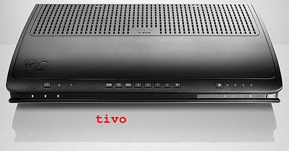

    I have a 360 box and a TiVo box upstairs and the 1gig broadband and e wi fi pods.
    As per Adduxi​  Try checking with Area faults on  0800 561 0061.

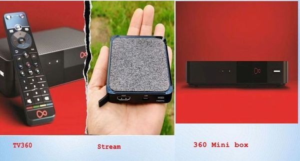

    You say you have a 360 box and also a Tivo box upstairs.  That could be an issue as tivo's aren't supported along with 360 box (they run on the horizon entertainment software platform, not tivo) on the same account. They shouldn't be able to run together.  Are you sure the other box is a tivo?  If it isn't a V6 upgraded to 360 then it should either be a mini TV360 (no hard drive) or a Stream box.
