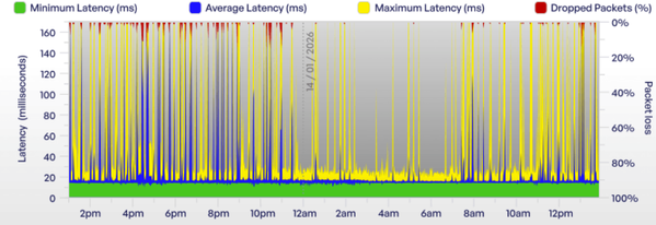

Latency/dropped packets for >3mo, no response from support
Hi
I logged my ongoing poor network performance issues (since installation) with support and I've not had any response to my emails chasing for updates. The status is just listed as "One of our team is looking into your issue." with my second submitted case status as below.
Maybe more than one of the team needs to look into it?
There was some maintenance in my area on the 10th which I'd vainly hoped might improve things but it hasn't. How do I escalate it (or obtain a response)?

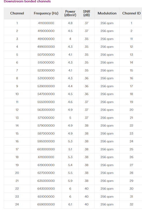

  • AI said the following - is it right?
    Downstream bonded channels (power, SNR, modulation)
    What you have
    Power levels: ~ +4 to +6 dBmV
    SNR: 35–40 dB
    Modulation: 256-QAM on all channels
    All channels locked
    What this means
    These downstream figures are excellent.
    Virgin Media acceptable ranges (DOCSIS 3.x):
    Power: –6 to +10 dBmV → ✔ well within range
    SNR for 256-QAM: ≥ 33 dB → ✔ comfortably above
    Channel bonding: full and stable → ✔
    📌 Conclusion:
    Your downstream RF signal is clean and healthy.
    This is not the cause of latency or packet loss.

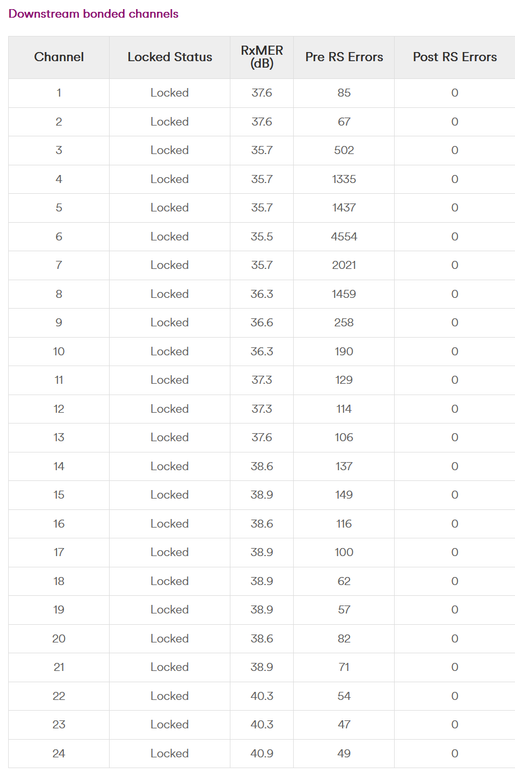

    Downstream errors (RxMER, Pre-RS, Post-RS)
    Key points
    RxMER: ~35.5–40.9 dB (excellent)
    Pre-RS errors: present, sometimes in the thousands
    Post-RS errors: zero
    What this means
    Pre-RS errors = corrupted data before error correction
    Post-RS errors = errors that could not be corrected
    DOCSIS uses Forward Error Correction (FEC):
    Your modem is seeing noise
    But it is successfully correcting every error
    📌 Conclusion:
    Downstream noise exists (normal on cable), but it is not breaking your connection and not causing packet loss.
    This again points away from downstream as the main problem.

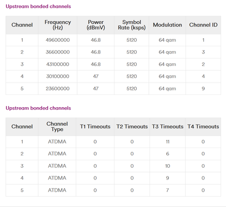

    Upstream bonded channels (this is the critical part)
    What you have
    Power: ~46.8–47 dBmV (all channels)
    Modulation: 64-QAM
    Symbol rate: 5120 ksps
    5 upstream channels bonded
    Why this matters
    Upstream is where latency problems usually originate on cable networks.
    Virgin Media typical targets:
    Ideal upstream power: 40–45 dBmV
    Acceptable upper limit: ~51 dBmV
    You are:
    High but not yet “out of spec”
    Right in the zone where noise or congestion causes instability
    📌 This means:
    Your modem is having to shout quite loudly to be heard by the cabinet (CMTS).
    T3 timeouts (smoking gun)
    Your data
    T3 timeouts:
    Channel 1: 11
    Channel 2: 6
    Channel 3: 10
    Channel 4: 9
    Channel 5: 7
    T4 timeouts: 0
    What a T3 timeout actually means
    “The modem sent a ranging request upstream, but the CMTS didn’t respond in time.”
    In plain English:
    Your modem spoke
    The network didn’t hear it clearly enough
    The modem had to retry
    This causes:
    Retransmissions
    Queueing delays
    Latency spikes
    Dropped packets (especially for real-time traffic)
    Even small numbers of T3s are enough to cause:
    Intermittent high ping
    Jitter
    Packet loss visible on ThinkBroadband BQM
    “Feels fine sometimes, awful at others”
    📌 T3s across all upstream channels = upstream noise or contention, not a single bad frequency.

    “My downstream levels are excellent, but upstream power is consistently ~47 dBmV and I am seeing repeated T3 timeouts across all bonded upstream channels. This correlates with latency spikes and packet loss. Please check for upstream noise ingress or a plant issue between my modem and the CMTS.”

    ThinkBroadband BQM screenshots (Done)
