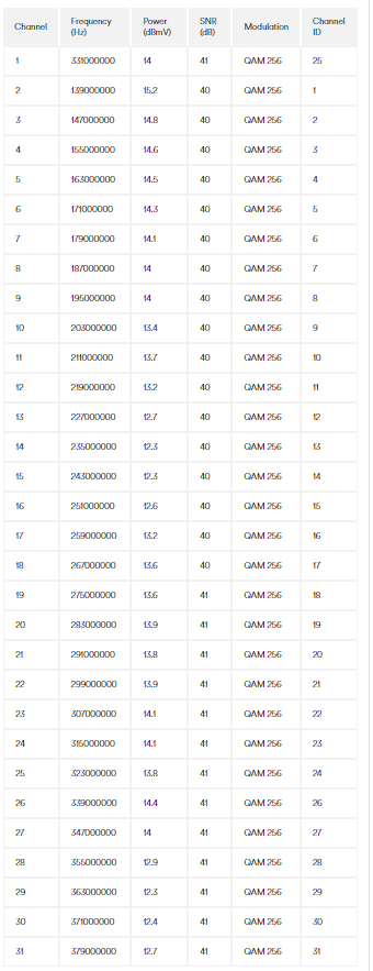

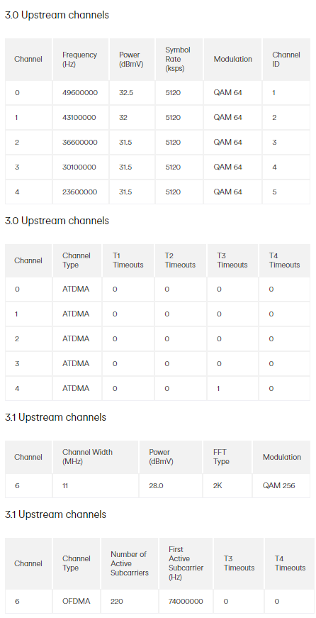

Hello to all owners of the unfortunate network that is Virgin Media, I am writing another post hoping that someone can help me with a problem that I have had for over a year now. I no longer have the strength or desire for pointless phone calls and visits from engineers who have no idea how to solve the problem (there were about 10 of them). For over a year since I moved into this address, every day, I repeat EVERY DAY, my internet has been disconnected for no reason, even at night when everyone is sleeping and no one is using any device, I lose my internet connection. I pay £50 a month for this service and the quality of this connection is not even worth £5. A lot of time wasted on the phone and waiting for an engineer who several times didn't even bother to come on the scheduled day, lack of strength and a lot of stress only to be disconnected by some 'internet' connection.
There is no question of playing any games, because during each game I have a huge lag, I lose the Internet connection and after some time everything returns to 'normal'. Virgin Media people are trying to blame which of the devices I have at home but everything I own is practically new. I got a new router, I think it was the 3rd time. New wiring inside and outside, everything was tested with their devices and apparently everything is OK, but after each visit of the engineer the problem returns and everything looks the same as before.

    Your DS power is too high and the US too low. They need to be fixed by VM first.
  • The engineer visited literally 4 days ago and said that everything is OK. Can they do it online somehow or do I need another visit from a 'specialist'?
