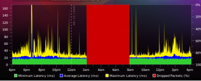

BQM graph below, note that I did actually get Internet back about 3pm. Just the ip address changed so still appeared as a packet loss.
https://www.thinkbroadband.com/broadband/monitoring/quality/share/2682f51a699ae8e8f857b47e3c99d5903d4984d4-08-11-2023

  • jbrennand's avatar
    jbrennand
    Firstly, the link gets a 404 error  - you need to screenshot it and blank out you ip address and post the photo - or follow instructions on the website to... "share live link".
    If its jus in the early hours, this is the time that VM make network changes/updates etc which causes loss of signal for a short period.  But, it usually doesnt continue for more than a day or two.  If it does it should be reported on the automated” Service Status number - 0800 561 0061 - see if anything is reported there.
    Also look in the Hub settings for the Network Logs page.  Are there any clues in those for the times you note the drops ?
