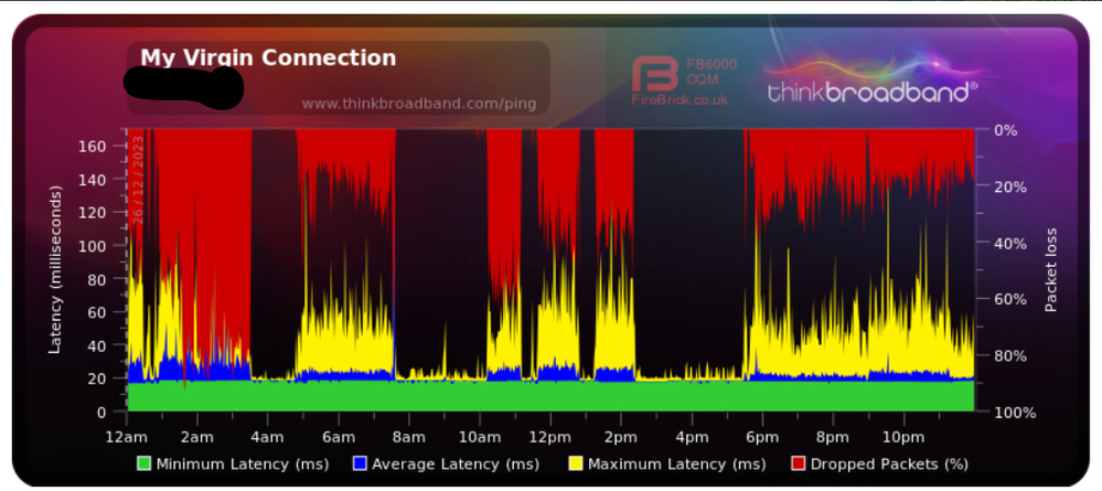

For the last month I have been experiencing poor internet connectivity. The internet will be fine for hours or days at a time but then connections start dropping and packet loss is so bad its very obvious when working or gaming etc
There are no reported problems in my area.
This is a screenshot of my connection on the 26th December!

    The patterns are quite odd, almost like an RFI emitting machine is turn on / off, but the times of night + day don't match with normal patterns for domestic or business activity.
    What do the VM Hub's Upstream and Downstream stats look like during one of the storms of dropped BQM Packets?

      No packet loss just now but I will check next time there are problems. The network log does have critical errors  No Ranging Response received - T3 time-out but no idea if relevant

  • Someone came out within a couple of days and fixed the issue. Possibly caused by dirt on the coax connections on the box on the internal wall. No packet loss at all since then so I think the problem is sorted.
