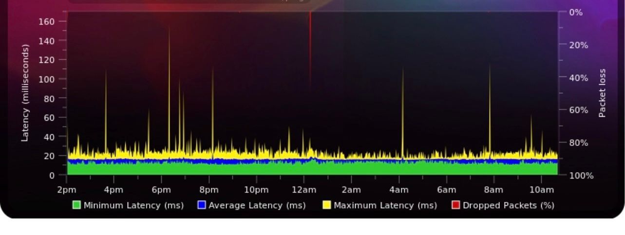

    • Sophr18's avatar
      Sophr18
      I’ve just set that up, will post back tomorrow with the results. Thanks for your help
  • jpeg1's avatar
    jpeg1
    Well that looks clear, apart for the brief spike at midnight. So it does look like an internal WiFi problem rather than the broadband feed.
    What speed are you on, which Hub? How far are your devices from the Hub? Do they drop out even very close to it?
