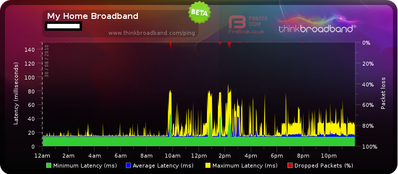

ThinkBroadband monitor from today
Spoiler
