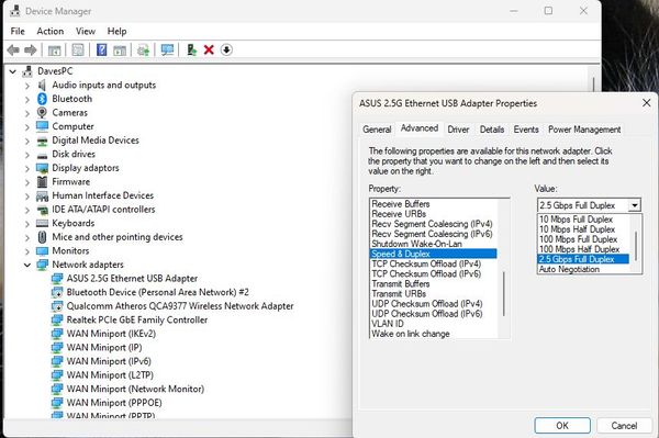

      The hub 5 has been shown to have speed issues with some devices when the ethernet cable is connected to the 2.5Gb port.   Some PC network adaptors do not auto negotiate to 2.5Gb/s, so you may need to set 2.5Gb/s manually in the Speed & Duplex options of the PC's NIC.
      Firstly try disabling EEE for the network adaptor, but you should also double check all EEE settings in device manager in case there are any additional EEE settings. My network adaptor has a few EEE settings which I have disabled:-
      Advanced EEE;  Energy_Efficient Internet; and Green Ethernet
      I have EEE Max Support Speed set to 2.5Gbps Full Duplex, and also Speed & Duplex set to 2.5Gbps Full Duplex
      Have you checked that your computers adapter settings are set to either 1.0 Gbps Full Duplex or  2.5G
      Press the Winows key and type in ethernet. Then select ethernet settings. Then change adapter settings. Double click Internet and it should show the speed as indicated on the picture below.
      If you need to change it change it, click Properties followed by Configure then scroll down as shown on the right and set the value to either 1.0 Gbps Full Duplex or 2.5 Gbps Full Duplex.

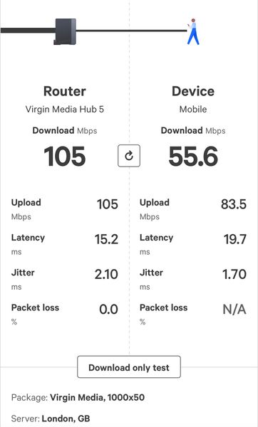

      I should have said - the VM customer service operators that I have spoken to have also confirmed the speed into the property is exceptionally slow.  So again, this isn’t a slow connection to a specific device.  It’s the direct speed into the HUB 5 that is problematic.  It has been consistently 1145 for 2 years, so it’s all very odd to me? 🤔
  • Hi. The hub is and has always been in router mode, no changes have been made to it or anything new added in the 2 years we upgraded to 1gig.  So it’s strange the problem has suddenly started.
    the speed test results are from to the hub with results from sam knows .  Both from windows pcs, Apple desktops, and Apple p ones and iPads.
    from all locations within the house the same result shows, the speed into the house is never above 100mb.
    obviously the speed on various devices changes, dependent on if it’s WiFi or hardwired, but my issue isn’t that.  It’s the speed into the property that has dropped significantly.
    Does this help at all?
      Please provide a screen shot from the Realspeed test having clicked on Run full test.
      https://samknows.com/realspeed/
      Seeing the full test screen shot is important to understanding if there is evidence of an external service issue to the VM Hub or it is an internal issue caused by Wi-Fi or a device operating at 100Mbps.
