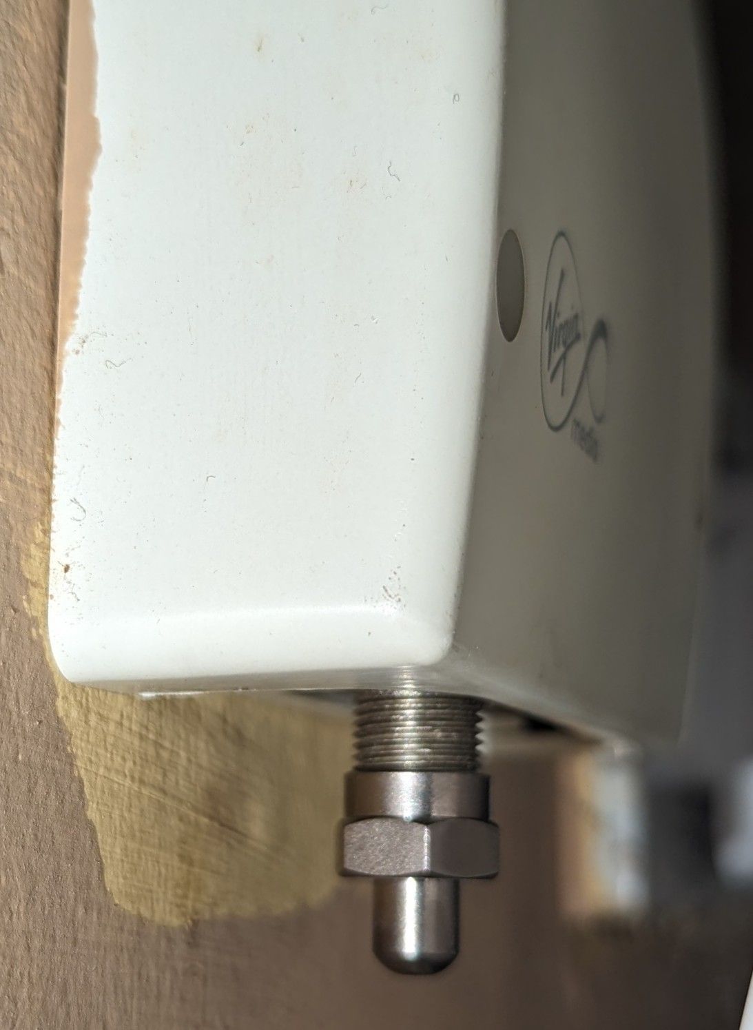

Taking a peek at the omnibox outside the house, I have noticed another connection has been added. We're now on 1 in and 3 out on this line, is this normal?
I've reset the hub 4 back to default factory settings as advised, but this hasn't helped. All Ubiquiti updates applied. I have a replacement hub 5 coming on Saturday but just wondered if it's normal to have such a busy omnibox?

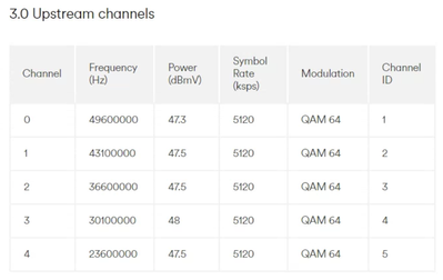

    It looks like you've taken all the necessary steps.  Now to the neighbours.  You do need to know the fullest picture possible - which isn't exactly what you get from VM.  If your neighbours don't have the same high upstream power, then, at least in terms of my knowledge, the problem lies in your Hub.   If there was noise generated in your home, it would propagate to other homes on the same cabinet .

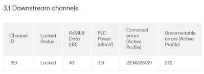

      Interestingly enough, the corrected error count on the new Hub 5 is already sitting at 2,294,325,139 (this was only set up on Saturday)… I wonder if this affected my Hub 4 and integer overflow caused it to die 🤔
      • Sephiroth's avatar
        Sephiroth
        Corrected errors are nothing to worry about if there are no uncorrected errors.  There will usually be a small number of uncorrected errors that can be put down to the initialisation stage when nothing is in sync and everything is gibberish.  My corrected error count n D3.1 is 2286557907 and I have no issues of any sort.
