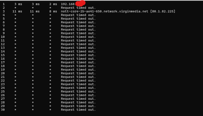

      Here is what i got from the tracert test, i dont understand what this means

    The tracert  ( trace route ) indicates the traffic in your area is getting stuck at a VM host known as :
    nott-core-2b-ae41-650.network.virginmedia.net [80.1.82.225]
    Until VM resolve that issue, your connectivity problems may persist.
    It will be interesting see if others in the same locality report similar problems.

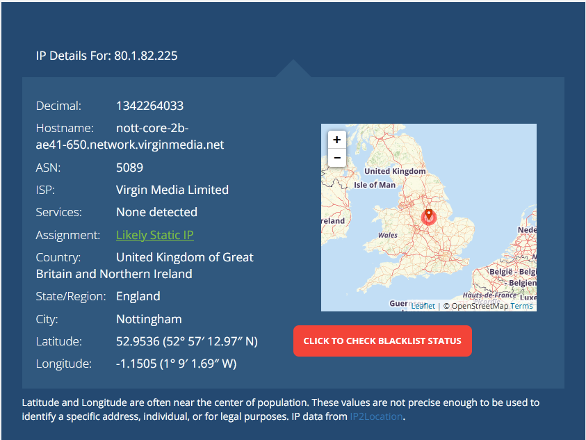

    https://whatismyipaddress.com/ip/80.1.82.225 suggests Nottingham as the locality.
