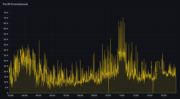

        I’ve been monitoring error stats on my modem. Even after the above work, I’m still seeing excessive Pre-RS errors (tens of thousands per second, peaking at over 70k in the last 12 hours).
        For context:
        • Pre-RS errors are errors detected before the modem’s error correction kicks in.
        • At this level, the modem is overwhelmed trying to correct them.
        • The result is high latency, jitter, and packet loss, even if raw speed tests sometimes look fine.
        Here’s a snapshot of today’s monitoring:
        The engineers I’ve spoken to have mentioned noise on the line — and these stats appear to confirm that. So while progress has been made with the cabinet and drop cable, the underlying issue clearly hasn’t been fully resolved.
