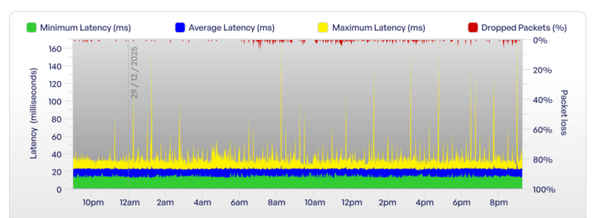

I’ve also monitored performance using ThinkBroadband BQM and observed clear packet loss and latency spikes aligning with the modem errors.

    As of 28 December, the BQM now shows:
    • Nednats's avatar
      Nednats
      Up to speed
      29 December, the BQM now shows:
      A lot of packet loss
