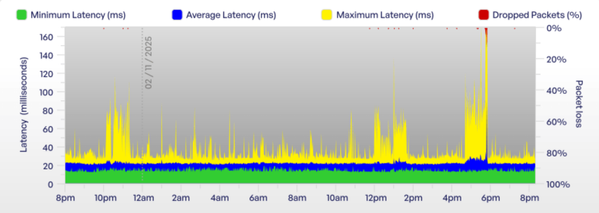

I’ve also monitored performance using ThinkBroadband BQM and observed clear packet loss and latency spikes aligning with the modem errors.

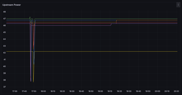

  • I wanted to share some monitoring data following a series of upstream issues on 2 November 2025, between 18:45 and 18:50. During this time, my connection dropped repeatedly, and my Hub 5 logs recorded multiple T2/T3 timeouts, “No Maintenance Broadcasts for Ranging” messages, and a TCS Partial Service event.
    The connection re-established itself after a few minutes, but the ThinkBroadband BQM shows clear packet loss and latency spikes during that same window. My logs also recorded a sharp dip in upstream power across all channels, which then gradually recovered.
    Example log entries:
    18:45:56 – 16 consecutive T3 timeouts on upstream channels 0–4
    18:46:31 – No Maintenance Broadcasts (T2 timeout)
    18:49:58 – TCS Partial Service
    18:50:11 – CM-STATUS Event Type 5 (channels 18–36)
    Everything points to a short-lived upstream noise or node-level issue, rather than anything inside my property. The line has been stable since, but these recurring bursts match what I’ve been observing for several months.
    How do I get this investigated by the Network team?
