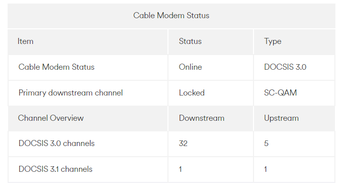

Hi all, hope you are doing well.
I just got a new contract with Virgin and a new Hub 5.
I hope I could use the old one but due to my new and apparently improved speed I need Hub 5.

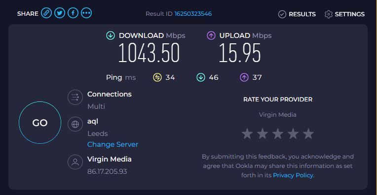

Anyway I wish someone could help me as when I test the speed the download apparently is very fast but the upload extremely slow. Please see the attached speed test results. When I repeat the test it fluctuates but the upload is always very low. This was done using a PC connected through an ethernet cable. Wifi is way worse.
Websites and most importantly my Zoom and Google Meet calls are just terrible and keep breaking up. I do work from home so this impacts me on a professional level. Phone Wifi keeps dropping all the time.
Here is info I have seen others post that might help?
Thank you in advance!

  • 3.0 Downstream channels
    Channel
    Frequency (Hz)
    Power (dBmV)
    SNR (dB)
    Modulation
    Channel ID
    1
    331000000
    -1.8
    40
    QAM 256
    25
    2
    139000000
    -1
    41
    QAM 256
    1
    3
    147000000
    0.1
    0
    QAM 256
    2
    4
    155000000
    -1.4
    41
    QAM 256
    3
    5
    163000000
    0.2
    41
    QAM 256
    4
    6
    171000000
    0.7
    41
    QAM 256
    5
    7
    179000000
    0.5
    41
    QAM 256
    6
    8
    187000000
    0.3
    41
    QAM 256
    7
    9
    195000000
    0.5
    41
    QAM 256
    8
    10
    203000000
    0.6
    41
    QAM 256
    9
    11
    211000000
    0.2
    42
    QAM 256
    10
    12
    219000000
    0.8
    41
    QAM 256
    11
    13
    227000000
    -1.1
    41
    QAM 256
    12
    14
    235000000
    0.9
    41
    QAM 256
    13
    15
    243000000
    -1.8
    41
    QAM 256
    14
    16
    251000000
    -1.8
    41
    QAM 256
    15
    17
    259000000
    -1.3
    41
    QAM 256
    16
    18
    267000000
    -1
    41
    QAM 256
    17
    19
    275000000
    -1
    41
    QAM 256
    18
    Channel
    Locked Status
    RxMER (dB)
    Pre RS Errors
    Post RS Errors
    1
    Locked
    40
    22
    159
    2
    Locked
    41
    8331
    55126
    3
    Locked
    0
    16644
    81144
    4
    Locked
    41
    32768
    145582
    5
    Locked
    41
    95563
    213705
    6
    Locked
    41
    79836
    578024
    7
    Locked
    41
    59329
    729814
    8
    Locked
    41
    318842
    819971
    9
    Locked
    41
    41
    80
    10
    Locked
    41
    20
    48
    11
    Locked
    42
    7
    101
    12
    Locked
    41
    0
    0
    13
    Locked
    41
    0
    0
    14
    Locked
    41
    0
    0
    15
    Locked
    41
    1
    7
    16
    Locked
    41
    8
    14
    17
    Locked
    41
    2
    7
    18
    Locked
    41
    19
    7
    19
    Locked
    41
    1
    23
    20
    Locked
    41
    16
    24
    21
    Locked
    41
    3
    14
    22
    Locked
    41
    35
    28
    23
    Locked
    40
    16
    74
    3.1 Downstream channels
    Channel
    Channel Width (MHz)
    FFT Type
    Number of Active Subcarriers
    Modulation (Active Profile)
    First Active Subcarrier (Hz)
    159
    94
    4K
    1840
    QAM 4096
    1108
    Channel ID
    Locked Status
    RxMER Data (dB)
    PLC Power (dBmV)
    Corrected errors (Active Profile)
    Uncorrectable errors (Active Profile)
    159
    Locked
    41
    -5.5
    123370847
    11013
    3.0 Upstream channels
    Channel
    Frequency (Hz)
    Power (dBmV)
    Symbol Rate (ksps)
    Modulation
    Channel ID
    0
    49600000
    50.5
    5120
    QAM 64
    1
    1
    43100000
    49.8
    5120
    QAM 64
    2
    2
    36600000
    49.8
    5120
    QAM 64
    3
    3
    30100000
    49.5
    5120
    QAM 64
    4
    4
    23600000
    48.8
    5120
    QAM 64
    5
    Channel
    Channel Type
    T1 Timeouts
    T2 Timeouts
    T3 Timeouts
    T4 Timeouts
    0
    ATDMA
    0
    0
    16
    1
    1
    ATDMA
    0
    0
    29
    1
    2
    ATDMA
    0
    0
    31
    2
    3
    ATDMA
    0
    0
    32
    2
    4
    ATDMA
    0
    0
    45
    2
    3.1 Upstream channels
    Channel
    Channel Width (MHz)
    Power (dBmV)
    FFT Type
    Modulation
    6
    10
    44.2
    2K
    QAM 256
    Channel
    Channel Type
    T3 Timeouts
    T4 Timeouts
    6
    OFDMA
    200
    74000000
    1
    1
  • I see some errors and critical in the log:
    Network Log
    Time
    Priority
    Description
    14-05-2024 16:38:46
    notice
    GUI Login Status - Login Success from LAN interface
    14-05-2024 16:34:54
    warning
    DBC-REQ Mismatch Between Calculated Value for P1.6hi Compared to CCAP Provided Value;CM-MAC=**:**:**:**:**:**;CMTS-MAC=**:**:**:**:**:**;CM-QOS=1.1;CM-VER=3.1;
    14-05-2024 16:33:53
    error
    DBC-ACK not received;CM-MAC=**:**:**:**:**:**;CMTS-MAC=**:**:**:**:**:**;CM-QOS=1.1;CM-VER=3.1;
    14-05-2024 16:33:51
    warning
    14-05-2024 16:32:50
    error
    14-05-2024 16:32:48
    warning
    14-05-2024 16:32:48
    notice
    US profile assignment change. US Chan ID: 6; Previous Profile: 12 13; New Profile: 13.;CM-MAC=**:**:**:**:**:**;CMTS-MAC=**:**:**:**:**:**;CM-QOS=1.1;CM-VER=3.1;
    14-05-2024 16:32:46
    warning
    RNG-RSP CCAP Commanded Power in Excess of 6 dB Below the Value Corresponding to the Top of the DRW;CM-MAC=**:**:**:**:**:**;CMTS-MAC=**:**:**:**:**:**;CM-QOS=1.1;CM-VER=3.1;
    14-05-2024 16:32:45
    critical
    Received Response to Broadcast Maintenance Request, But no Unicast Maintenance opportunities received - T4 time out;CM-MAC=**:**:**:**:**:**;CMTS-MAC=**:**:**:**:**:**;CM-QOS=1.1;CM-VER=3.1;
    14-05-2024 16:32:24
    warning
    14-05-2024 16:32:24
    notice
    US profile assignment change. US Chan ID: 6; Previous Profile: 11 13; New Profile: 12 13.;CM-MAC=**:**:**:**:**:**;CMTS-MAC=**:**:**:**:**:**;CM-QOS=1.1;CM-VER=3.1;
    14-05-2024 16:31:59
    notice
    CM-STATUS message sent. Event Type Code: 24; Chan ID: 159; DSID: N/A; MAC Addr: N/A; OFDM/OFDMA Profile ID: 3.;CM-MAC=**:**:**:**:**:**;CMTS-MAC=**:**:**:**:**:**;CM-QOS=1.1;CM-VER=3.1;
    14-05-2024 16:29:10
    critical
    Started Unicast Maintenance Ranging - No Response received - T3 time-out;CM-MAC=**:**:**:**:**:**;CMTS-MAC=**:**:**:**:**:**;CM-QOS=1.1;CM-VER=3.1;
    Thank you!
